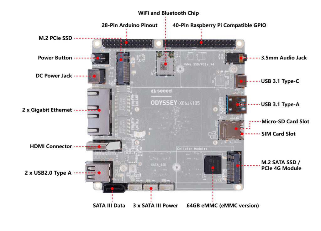

  • Intel® Celeron® J4105, Quad-Core 1.5-2.5GHZ
  • Dual-Band Frequency 2.5GHz/5GHz Wi-Fi/ Bluetooth 5.0
  • Intel® UHD Graphics 600
  • Dual Gigabit Ethernet
  • Integrated Arduino Coprocessor ATSAMD21 ARM® Cortex®-M0+
  • Raspberry Pi 40-Pin Compatible
  • 2 x M.2 PCIe (B Key and M Key)
  • Pre-installed with Windows10 Enterprise
  • Compatible with Grove Ecosystem

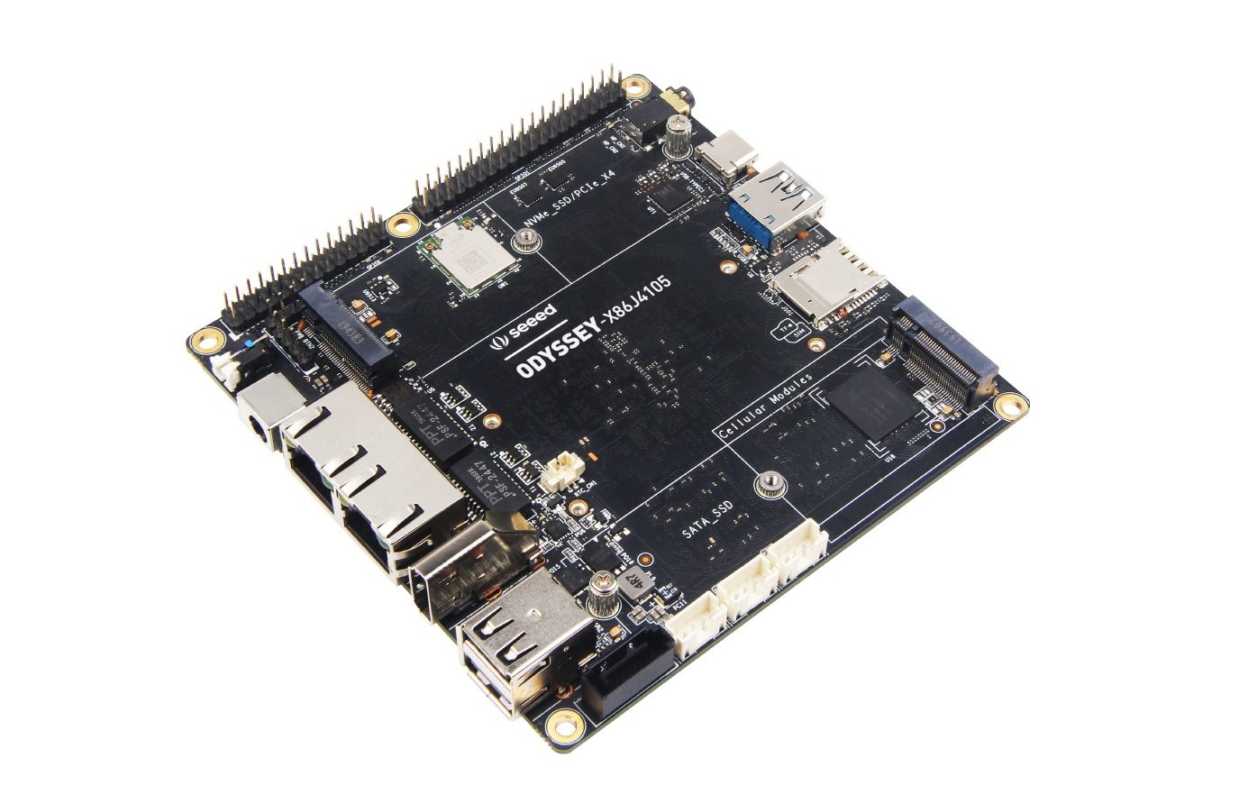

The Odyssey goes a step above typical Mini PCs, and the included Microchip ATSAMD21G18 coprocessor makes it ideal for working as an Arduino prototyping platform and allows you to connect and control sensors, actuators, and any other Arduino compatible hardware. The board is fitted with a 40-pin Raspberry Pi-compatible header and a 28-pin header for extending out the SAMD21G18. Aside from the possibility of the onboard 64GB eMMC, its SATA III data connector and three SATA power headers, mSATA socket, and micro SD slot allows the board to connect to any external memory unit and expanded the storage as much as possible.
The board comes with two primary display ports: HDMI 2.0a (Up to 4096×2160 @ 60Hz 24bpp) and Display Port 1.2 (Up to 4096×2160 @ 60Hz 24bpp), but can also be extended through the USB 3.1 Type-C port where external peripherals can also be attached. The HDMI provides audio as well as through the microphone/headphone combo connector and front panel audio connector.
