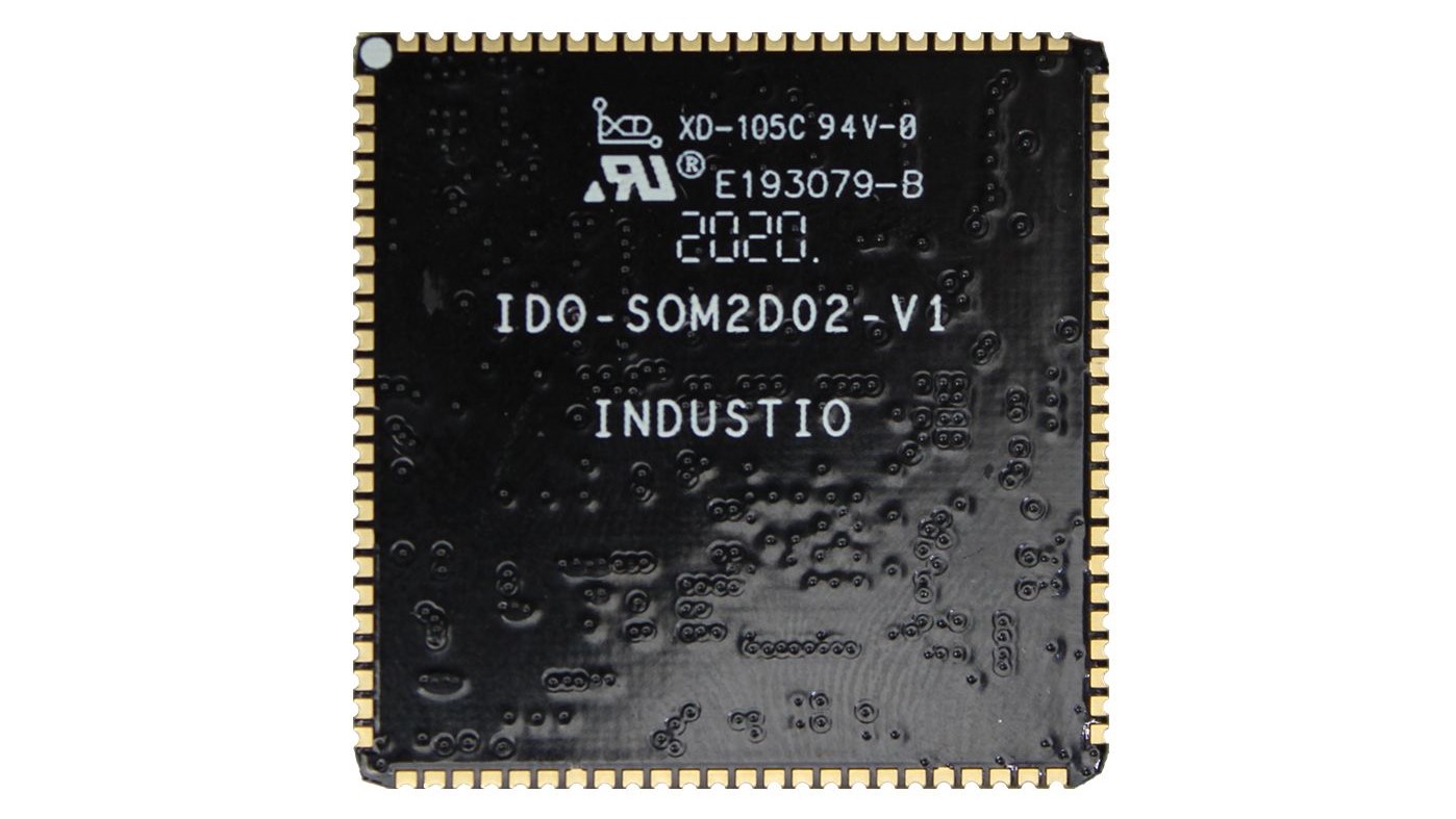

“This SoM has a single-sided layout which means the back of the PCB is completely flat and has no traces. This helps to get rid of any interference when using this board with a carrier board.”
IDO-SOM2D02-V1-2GW SoM Back
