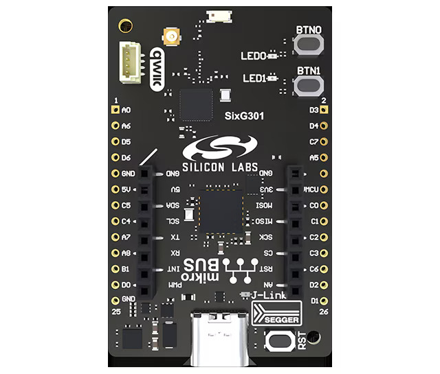

Developers can use the SixG301 Explorer Kit development and evaluation platform to begin prototyping for the Series 3 SoCs
Developers can use the SixG301 Explorer Kit development and evaluation platform to begin prototyping for the Series 3 SoCs. Image used courtesy of Silicon Labs
