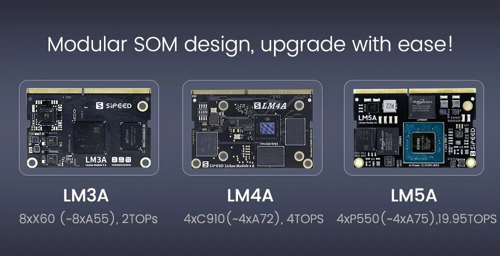

The TH1520 is born out of the Wujian 600 platform unveiled by Alibaba in August 2022 and is capable of running desktop-level applications such as Firefox browser and LibreOffice office suite on OpenAnolis open-source Linux-based operating system launched by Alibaba in 2020.
In our previous post, we also wrote about the Lichee Console 4A, a compact laptop powered by a Lichee Pi 4A RISC-V processor. It has 16GB of RAM, multiple storage options, and built-in Wi-Fi. Feel free to check this out if you are looking for similar products.

  • SOM: Sipeed LM4A
    • SoC: Alibaba T-Head TH1520
      • CPU:
        • Quad-core RISC-V Xuantie C910 (RV64GCV) processor @ 1.85 GHz
        • low power Xuantie E902 core
      • DSP: Xuantie C906 audio DSP @ 800 MHz
      • GPU: IMG BXM-4-64 GPU, supports OpenCL 1.1/1.2/2.0, OpenGL ES 3.0/3.1/3.2, Vulkan 1.1/1.2, and Android NN HAL
      • NPU:  4TOPS@INT8, up to 1GHz supports TensorFlow, ONNX, Caffe

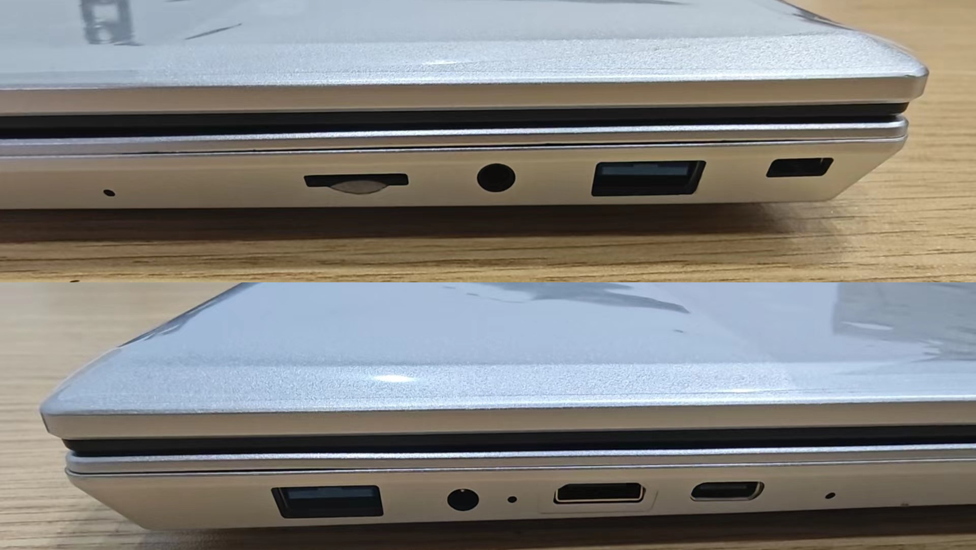

  • Interface:
    • USB3.0 Type-A, USB3.0 Type-C, USB2.0 Type-A
    • MicroSD Slot
  • User input: 88-keys compact keyboard and touchpad

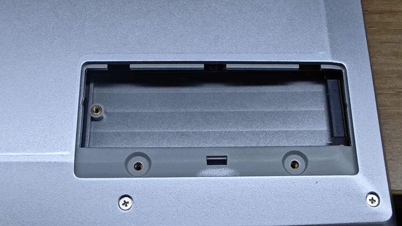

The Book supports M.2 2280 SATA SSDs, which can be installed by removing the SSD cover on the back. If you do not plan to use an SSD, you can manually turn off the USB-to-SSD chip to reduce power consumption (about 0.6 watts) and extend battery life.
