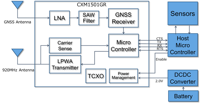

The new CXM1501GR communication module integrates a newly developed transmitter LSI that transmits signals conforming to the protocol of the ELTRES™ wireless communication standard in the 920MHz band as well as a circuit for impedance matching with an externally mounted antenna. Also included are a GNSS receiver LSI—an important IoT sensor that obtains time and position information—and high-frequency components such as the SAW filter required for the GNSS receiver. With all of these components built in, this product expands the ease and versatility of IoT edge device design.
Main Features
  1. Built-in π/2-shift BPSK modulation (biphasic deviation modulation) LSI that operates on low power and produces a favorable SN ratio in narrow bandwidth communication.
  2. Built-in impedance-matching circuit for 920MHz external antenna allows for direct connection to a general-purpose antenna and enables custom antenna to be designed easily.
  3. Built-in high-sensitivity, low-power GNSS LSI for compatibility with GPS, GLONASS, and QZSS.
  4. Built-in high-frequency circuit optimized for GNSS reception enabling direct connection to antennas.

CXM1501GR diagram and system configuration sample
