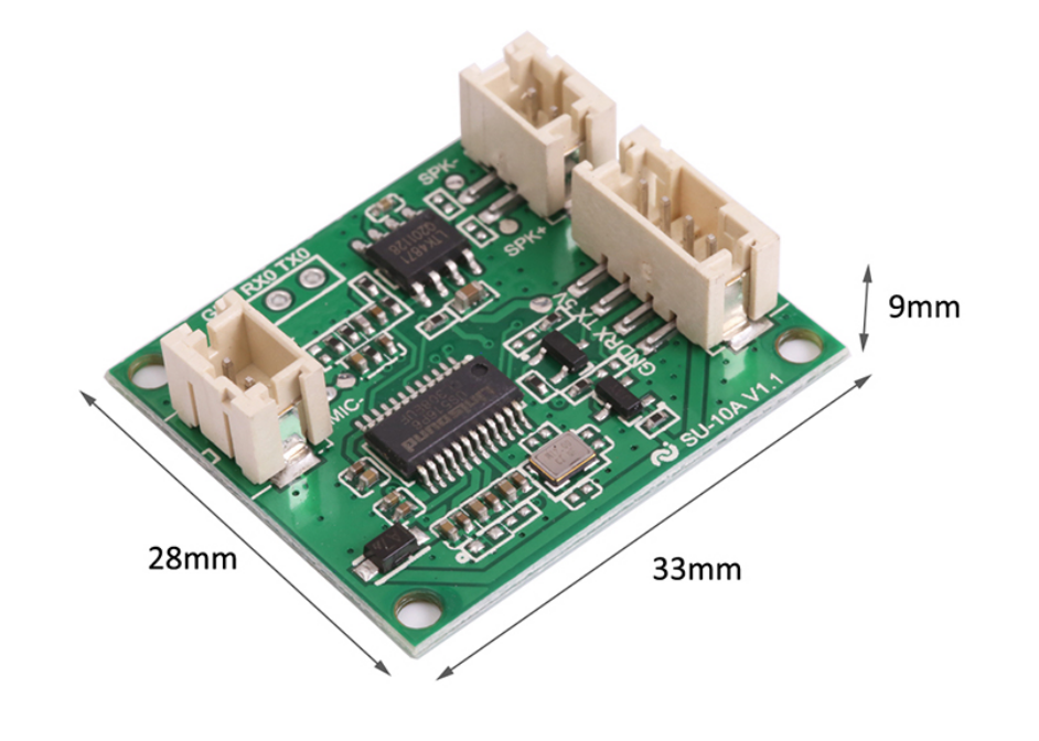

PCB of SU-10A Speech Recognition Module
The module comes with the 32bit RISC core featuring the Unisound US516P6 microcontroller. It operates at a high frequency of 240MHz, thus supporting the extensive computation for speech recognition on the module itself. Discussing further, it contains 242kB of SRAM and 2MB of flash memory, which seems to be enough for accommodating the speech data. Additionally, it comes with a floating-point unit and accelerators for digital signal processing (DSP) and fast Fourier transform (FFT) computations.

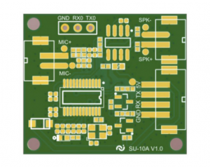

  • UART port for the serial console to program the module.
  • 2mm pitch 4-pin connector for UART (Tx/Rx) to host MCU.
  • The dimensions  of the module are 33mm x 28mm x 9 mm
