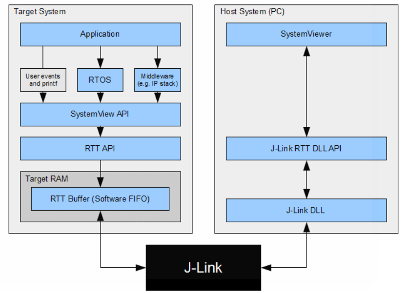

SystemView gives a complete insight of what is going inside the MCU graphically and in real time. All recorded data is fetched using J-link adapter with no extra hardware or extra pins. SystemView app requires small software module (< 2 KB) to be included in the device.
SystemView app GUI
The SystemView module collects the data and passes it to Real Time Transfer (RTT). The RTT module stores the data in the device buffer, which enables continuous recording. SystemView has the ability of analyzing which interrupts, tasks and software timers executed, how many times and when.
