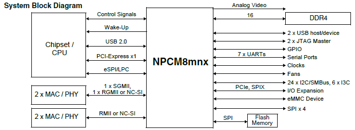

A traditional BMC implementation requires numerous discrete components, resulting in a larger footprint and more complex PCB design, often with high-speed signal routing, power sequencing, and extensive passive components. The NPCM8mnx-SiP challenges the status quo by integrating all essential BMC components into a single 23x23mm² BGA package. According to Nuvoton, this reduces the subsystem area by approximately 70% compared to a discrete approach.
This single-package solution includes the core Arbel NPCM8mnx BMC, embedded DDR4 memory (1 GB to 4 GB), eMMC storage (8 GB to 64 GB), and NOR Flash (16 MB to 128 MB). It also incorporates a reference clock oscillator, voltage regulators, and 120+ passive components. This level of integration intends to simplify and speed up the development process by eliminating the need for high-speed signal simulations and complicated PCB layouts.
Block diagram of the Arbel NPCM8mnx SiP
Block diagram of the Arbel NPCM8mnx SiP. Image used courtesy of Nuvoton Technology Corporation

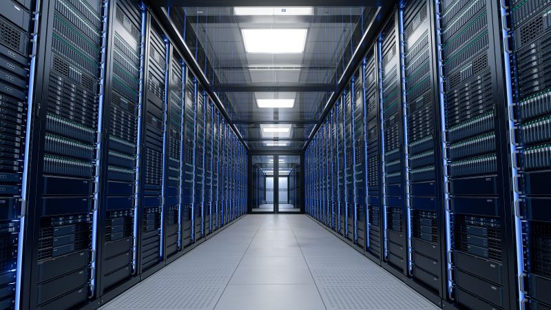

Nuvoton has built the NPCM8mnx-SiP to reduce design complexity in AI servers and data center platforms
Nuvoton has built the NPCM8mnx-SiP to reduce design complexity in AI servers and data center platforms. Image used courtesy of Adobe Stock

The Arbel NPCM8mnx offers a comprehensive mix of peripherals for BMC applications, including network interfaces, USB host and device, and remote access via KVM or SOL. For baseboard management, it provides interfaces like I2C, I3C, PECI, PWM, Tacho, and GPIOs. Host interfaces include KCS, UARTs, and mailboxes. For system expansion and connectivity to FPGAs or CPLDs, the device features a PCIe root-complex and SPIx.
