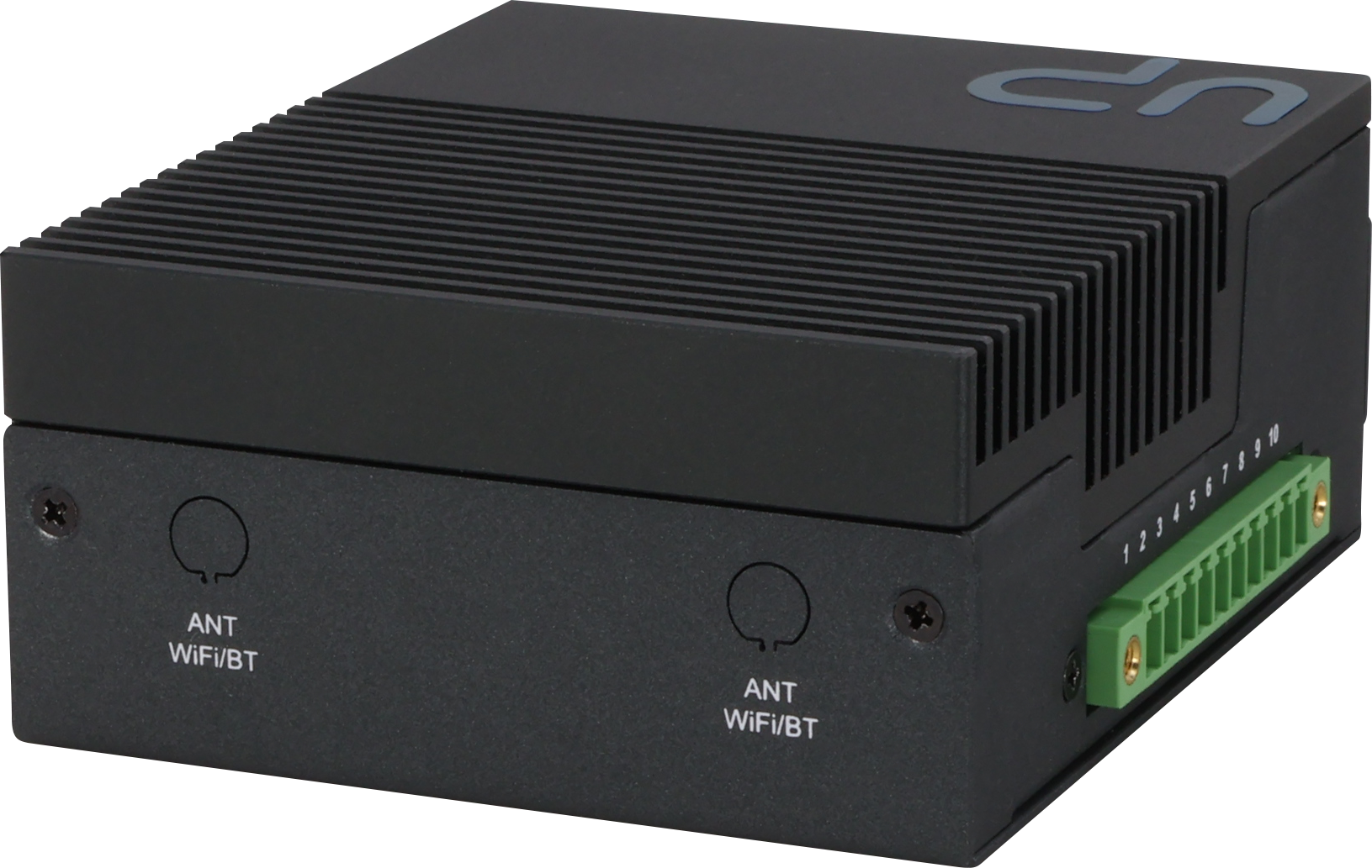

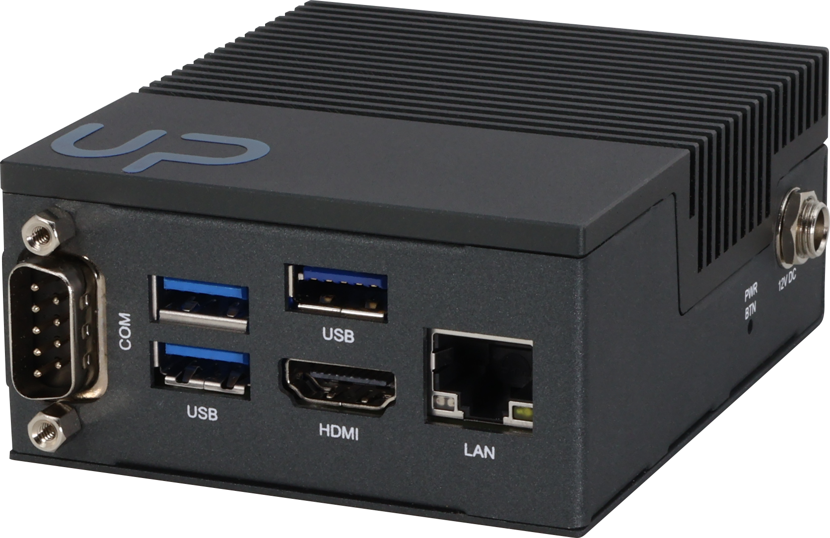

Positioned as a compact platform for companies to upgrade industrial automation setups, the UP 710S Edge is available in models featuring the full Intel® Processor N series family (formerly Alder Lake-N), as well as offering an 8-bit GPIO with optional SPI, I2C, and PWM, a first for the product line.
In addition to its GPIO, the UP 710S Edge introduces both a COM port for RS-232/422/485 and an M.2 2230 E-Key slot to the series, granting users convenient Wi-Fi support. Rounding off the system’s I/O are three USB Type-A ports with USB 3.2 Gen 2 signals, gigabit Ethernet, and an HDMI output.
