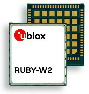

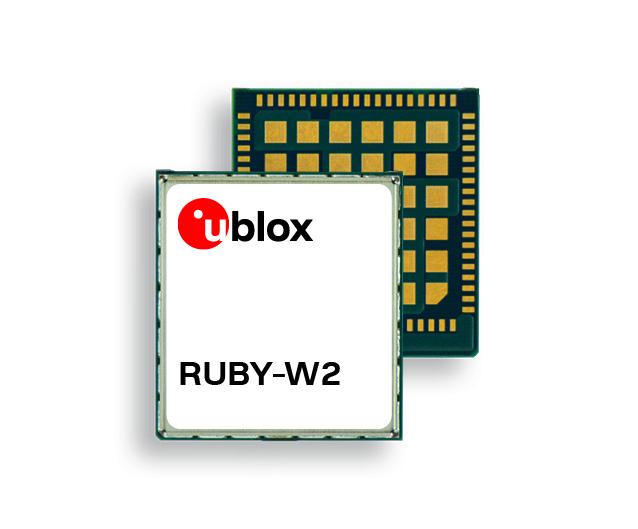

u-blox has introduced its first industrial automotive-grade Wi-Fi 7 host-based modules, the RUBY-W2 series (RUBY-W273-05A and RUBY-W295-05A). These modules enable OEMs to enhance in-vehicle infotainment and telematics by supporting Multi-Link Operation (MLO) use cases, delivering high-performance wireless connectivity.
Powered by automotive-qualified Qualcomm QCA6797AQ or QCA6787AQ chipsets, the RUBY-W2 modules support tri-band Wi-Fi 7 and dual-mode Bluetooth 5.4. They offer up to 5.8 Gbit/s (PHY) throughput in High Band Simultaneous (HBS) mode, making them ideal for in-car hotspots, Apple CarPlay, and multi-client video streaming.
Designed for the automotive market, the RUBY-W2 series improves network availability, increases throughput, reduces latency, and supports more concurrent users. Key features include Multi-Link Operation (MLO) with Dual Band Simultaneous (DBS) and High Band Simultaneous (HBS) modes, 2×2 MU-MIMO, Bluetooth LE Audio, long-range Bluetooth, WPA2/3 security, and secure boot.

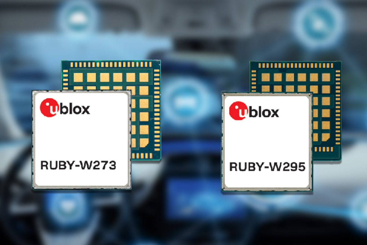

u-blox RUBY-W2 Series Specifications:
  • Chipset:
    • RUBY-W273-05A: Qualcomm QCA6787AQ
    • RUBY-W295-05A: Qualcomm QCA6797AQ
  • Wireless:
    • Tri-band Wi-Fi 7 (IEEE 802.11 a/b/g/n/ac/ax/be)
    • RUBY-W273: Dual Band Simultaneous (DBS) (2.4 GHz + 5/6 GHz)
    • RUBY-W295: High Band Simultaneous (HBS) with any two bands (2.4, 5, or 6 GHz)
    • Channel bandwidth: 20, 40, 80, 160, and 320 MHz (HBS only for 320 MHz)
    • Max PHY rate: 5.8 Gbps
    • Modes: Access Point, Station, Peer-to-Peer (P2P), Wi-Fi Direct, Multi-Link Operation (MLO)
    • Security: WPA2/WPA3, AES/CCMP, AES/GCMP, WAPI
    • Bluetooth:
      • Dual-mode Bluetooth 5.4 (Classic BR/EDR + Low Energy)
      • Features: LE Audio, long-range, extended advertising, isochronous channels
      • Max simultaneous connections: 20
  • Host Interfaces:
    • Wi-Fi: PCIe Gen 3
    • Bluetooth: High-speed UART, 4-wire, PCM/I2S (audio)
    • Coexistence: WSI-2 interface for LTE/5G NR, I/Os for 5G NR, and LTE-LAA coexistence
    • GPIOs
  • Audio: Supports Snapdragon Sound Technology Suite
  • Power Supply: 3.3 V / 1.9 V / 1.8 V / 1.35 V / 0.95 V
  • Dimensions:
    • RUBY-W273: 23 x 23 x 3 mm
    • RUBY-W295: 23 x 25 x 3 mm
  • Package: Solder pins (LGA), 112 pins including central pads for ground and power
  • Operating temperature: -40°C to +105°C
  • Certifications:
    • Europe (RED), US (FCC), Canada (ISED), Great Britain (UKCA), Japan (Giteki)
    • Bluetooth v5.4 qualification
    • RoHS and REACH compliance
    • AEC-Q104 qualification
    • Manufactured in line with ISO/TS 16949 standards
