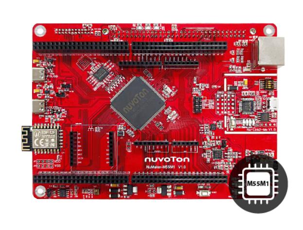

Nuvoton’s NuMaker-M55M1
The M55M1 series is known for its performance in digital signal processing and on-device ML interface. It offers a set of communication and peripheral interfaces to establish a connection between the I/O devices with the processor. It supports the Hyperbus and OctoSPI interface, which is crucial in the expansion of RAM. Hyperbus supports high Bandwidth and transfers data at DDR and OctoSPI uses 8 parallel data lines to achieve Octal Communication.
Nuvoton NuMaker-M55M1
The NuMaker-M55M1 is proficient in managing a variety of tasks, including dealing with audio processing, facilitating communication, executing machine learning operations, sensor fusion, and controlling motors. In essence, it serves as a capable solution for applications that require handling audio, communication, computational learning, sensor integration, and motorized movements.

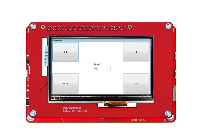

Nuvoton’s NuMaker-HMI-M467
The HMI-M467 integrates touch screen display, voice I/O, serial port service, and I/O interface, providing multiple external storage methods.
NuMaker-HMI-M467
The HMI-M467 consists of two parts: a base board and a daughter board. The daughter board extends the NuMaker evaluation boards. The NuMaker-TFT-LCD43 requires the motherboard to create an HMI development platform. It is equipped with a 4.3” 480 x 272 px RGB TFT-LCD and capacitive touch panel.
The HMI-M467 supports multiple graphics libraries, such as RT-Thread LVGL and emWin. This versatility ensures that users have options when it comes to building GUI applications. By providing compatibility with different graphics libraries, the HMI-M467 allows developers to choose the one that best suits their preferences or project requirements.

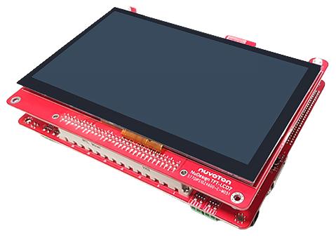

Nuvoton’s NuMaker-HMI-MA35D1-S1
The NuMaker-HMI-MA35D1-S1 evaluation board features a System-on-Module (SoM) that streamlines system design by integrating essential components such as the microprocessor, power management, DDR memory, and flash storage. This setup enables developers to concentrate on application-specific features. The board supports multiple Ethernet ports, USB connectivity, CAN FD, and various serial communication options. CAN FD helps facilitate the broadcast of sensor data and control information between electronic instruments and control systems.

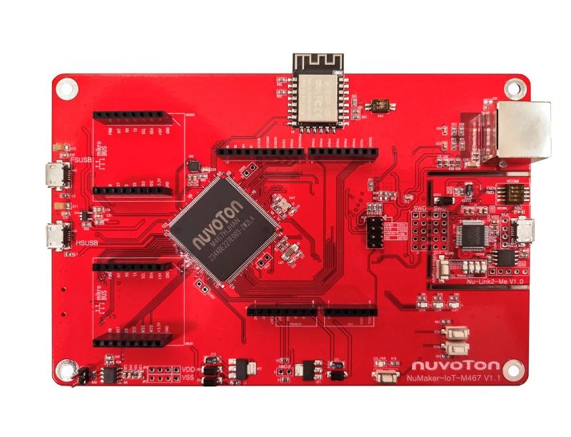

Nuvoton’s NuMaker-IoT-M467
The NuMaker-IoT-M467 IoT Platform is an IoT application platform developed by Nuvoton. It supports Arm Mbed OS v6 as well as Arduino and mikroBUS interfaces and is ideal for arrays of IoT application development for prototype designs with sensors and wireless modules.
The M467 target board is designed for industrial IoT applications, featuring a Wi-Fi module and a CAN FD transceiver. The Wi-Fi module enables wireless connectivity, allowing users to connect their industrial IoT applications to local networks or the internet. This connectivity facilitates data transmission, remote monitoring, and control of devices, enhancing the functionality and accessibility of the IoT applications being developed.
The IoT-M467 also provides Ethernet 10/100 MAC with RMII interface, USB 2.0 FS device/host/OTG, USB 2.0 HS device/host/OTG. It also includes a thermal sensor and a 6-axis sensor for rapid development. With Arduino UNO compatible headers and support for multiple power supplies, it offers flexibility for development. It features a Nuvoton-designed ammeter connector for instant power consumption measurement, crucial for prototype evaluation.
The IoT-M467 is equipped with plenty of peripherals, such as timers, watchdog timers, RTC, PDMA, UART, SD host, SPI, I²C, PWM, GPIO, CAN, ADC, temperature sensor and low voltage reset controller.
