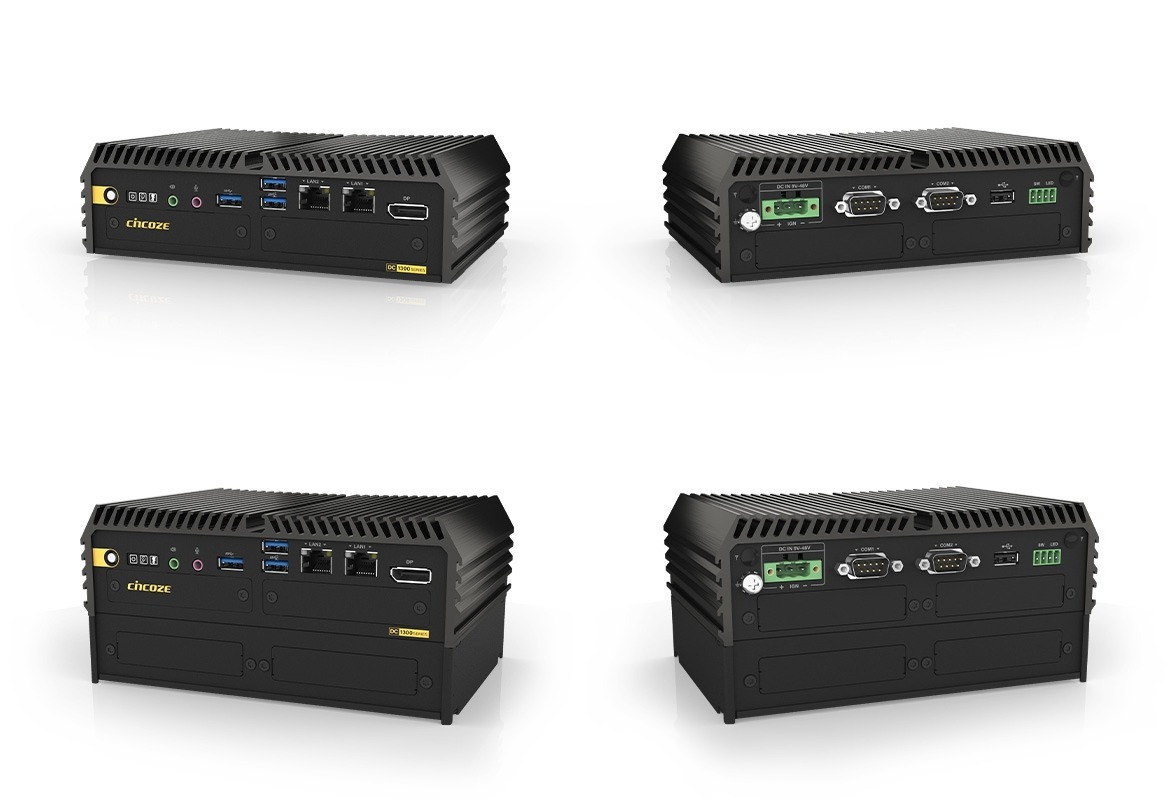

Cincoze has introduced the DC-1300 series, an entry-level compact industrial computer under the DIAMOND product line, designed for factory automation and industrial applications. The system is built with an Intel Core i3 or N97 (Alder Lake-N) processor and housed in a 185 x 131 x 56.5 mm chassis.
Cincoze has introduced the DC-1300 series, an entry-level compact industrial computer under the DIAMOND product line, designed for factory automation and industrial applications. The system is built with an Intel Core i3 or N97 (Alder Lake-N) processor and housed in a 185 x 131 x 56.5 mm chassis. It supports up to 16GB DDR5 4800MHz memory in a single slot and includes an M.2 slot for NVMe SSD storage.
The DC-1300 integrates multiple native I/O interfaces, including LAN, USB, COM, and a 4K DisplayPort. It supports additional COM, DIO, display, and IGN functions via Cincoze’s CMI/CFM expansion modules. A new Stackable Expansion Box (SEB) utilizes dual M.2 B Key slots to enable I/O, CANbus, and Fieldbus module support. These features make it suitable for applications in smart manufacturing, transportation, and energy management.

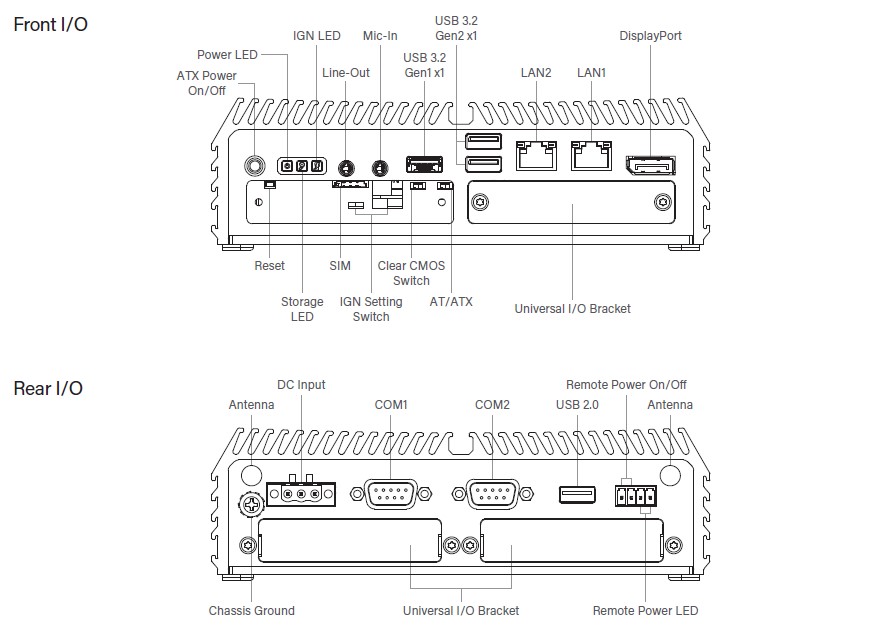

    • 2x 2.5GbE LAN, RJ45 port via Intel I225 controllers
    • Optional Wi-Fi and Bluetooth via M.2 socket
    • Optional 4G LTE/5G via M.2 socket and front-accessible dual Nano SIM card socket
    • 2x antenna holes
  • USB:
    • 2x USB 3.2 Gen2x1 (10Gbps), Type A
    • 1x USB 3.2 Gen1x1 (5Gbps), Type A
    • 1x USB 2.0 (480Mbps), Type A
  • Serial: 2x RS-232/422/485 DB9 COM ports with Auto Flow Control (supports 5V/12V)

    • M.2 Key B Type 3042/3052 Socket (PCIe Gen 3×1/ USB3.2 Gen2 x1 / SATA); supports 5G/storage/add-on card expansion
    • M.2 Key B Type 2242 (PCIe Gen 3×1), support add-on card expansion
    • CMI (Combined Multiple I/O) interface for optional Display or I/O Module Expansion
    • CMI Interface for optional I/O Module Expansion
    • CFM (Control Function Module) interface for optional IGN Module Expansion
  • Misc:
    • AMI BIOS
    • Clear CMOS Switch
    • Reset Button
    • Instant Reboot: 0.2sec Instant Reboot Technology
    • Watchdog Timer
    • Status LED Indicator – Power LED, Storage LED, IGN LED
    • ATX Power On/Off Button
    • AT/ATX Mode Switch
    • Remote Power On/Off via 2-pin terminal block
    • Remote Power LED via 2-pin Terminal Block
  • Power Supply: 9V to 48V DC via 3-pin terminal block

The Cincoze DC-1300 features a compact 185 x 131 x 56.5 mm design, making it suitable for space-constrained installations. It supports multiple mounting options, including wall mount, side mount, and DIN-Rail, enabling flexible deployment in machines, control cabinets, and automated guided vehicles (AGVs).
Built for rugged industrial environments, the fanless DC-1300 is designed to withstand extreme conditions, with an operating temperature range of -40 to 70°C and wide voltage input (9-48V DC). It meets EMC standards (IEC 61000-6-2/4) and complies with the MIL-STD-810H military shock standard, ensuring stable operation in demanding applications. The system supports Windows 11, Windows 10, and Linux via Ubuntu 22.04 LTS Desktop, providing compatibility with a wide range of industrial software and automation platforms.
