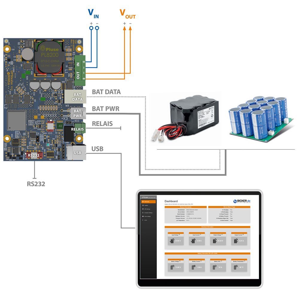

Intelligent charging and control unit UPSI
The compact charging and control module Bicker UPSI is connected to the appropriate energy storage device (LiFePO4 or Supercaps) via two cables. In addition to the energy transmission line (BAT PWR), all relevant operating data of the energy storage device is continuously monitored and controlled on the data line (BAT DATA) via the I2C interface. When changing the energy storage, which is even possible during operation (‘hot swapping’), a battery type ID authentication is carried out so that the appropriate charging and discharging parameters can be set automatically on the DC UPS.
PowerSharing function
On the input side, the intelligent ‘PowerSharing’ function ensures that the upstream AC/DC power supply does not have to be overdimensioned, but that the input power is kept constant and appropriately distributed to the load and battery charger. This means that when there is a low load at the output, more energy flows into the charger and vice versa.
Minimum load detection
The ‘minimum load detection’ of the UPSI control unit monitors the output load to be supplied from the energy storage in backup mode (battery mode). If the load at the output falls below a certain limit value, the energy storage device is automatically disconnected from the charging and control unit, so that the energy store is not unnecessarily emptied by the DC UPS electronics. In addition, the minimum load detection ensures that the computer system has been shut down properly after an initiated shutdown process, before the reboot function initiates the restart of the system.
