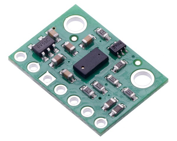

VL53L0X is a laser-ranging sensor that uses Time Of Flight (ToF) measurements of infrared pulses for calculating the distance of the facing surface. It can measure distances up to 2 meters with a resolution of 1 mm. This sensor works over an input voltage range of 2.6V to 5.5 V, and the measured values can be read through an I²C interface.
VL53L0X Sensor - Image courtesy of Pololu
VL53L0X Sensor – Image courtesy of Pololu
To get the best result, Vl53L0X must be attached on the bottom of the box as shown in this figure.

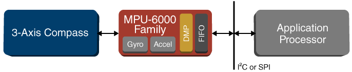

MPU-6050 is a low power, low cost, and high-performance motion tracking device, it contains 3-axis gyroscope and a 3-axis accelerometer with an onboard Digital Motion Processor (DMP™) which can be programmed with firmware and is able to do complex calculations with the sensor values and uses I²C interface. This sensor is used here for detecting the horizontal direction and for measuring X and Y axis acceleration.
mpu-6000-family-diagram
