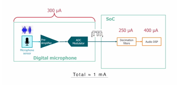

Most of current solutions for voice recognition use digital signal processors (DSPs) connected with A/D converters and they work in permanent wake mode which make them consume high amounts of  power in case of IoT applications and smartphones.

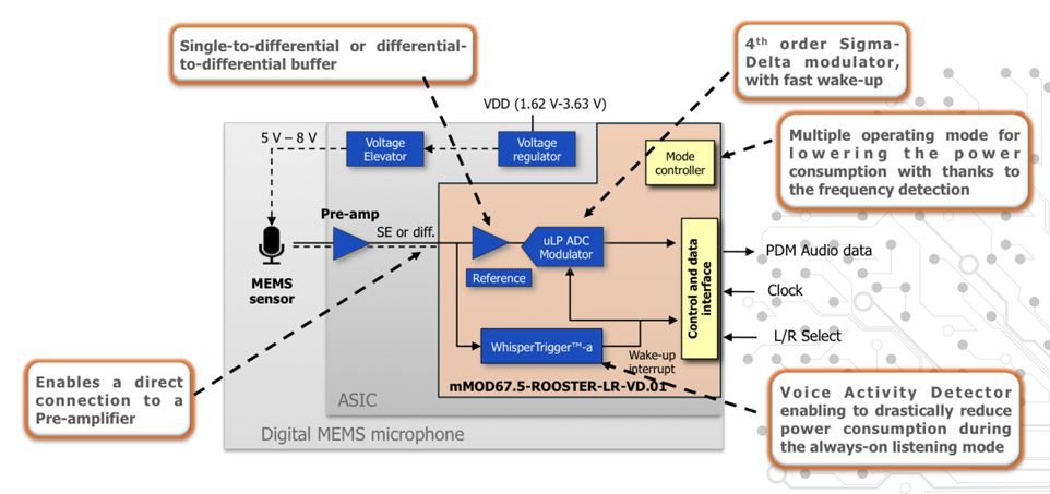

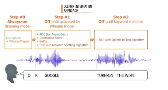

Dolphin Integration, a French corporation works on enabling low-power Systems-on-Chip and provides a solution called “Whisper Trigger”, an ultra-low power voice detector with outstanding performance of detection, enabling wake-up voice acquisition and recognition when needed. In comparison with other devices, this technology reduces power consumption by 80-90%. It consumes only 20 µA, and needs just 1 millisecond to wake up.
voice_detect_2
Dolphin Integration provides also another solution for text recognition and detection of keywords, the Microelectromechanical System (MEMS) which should be connected to DSP and circular buffer to perform the process of conversion, decimation and filtering.
