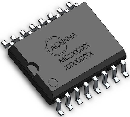

ACEINNA announced the high current ±65 Amp MCx1101 Current Sensor, the industry’s most accurate and highest bandwidth current sensor. Designed for WBG (wideband gap) applications, and available in 3.3- and 5-Volt versions, this highly accurate, wide bandwidth AMR-based (Anisotropic Magnetoresistive) current sensor is ideal for a wide range of next generation power systems and applications.
Power by mixos
ACEINNA announced the high current ±65 Amp MCx1101 Current Sensor, the industry’s most accurate and highest bandwidth current sensor. Designed for WBG (wideband gap) applications, and available in 3.3- and 5-Volt versions, this highly accurate, wide bandwidth AMR-based (Anisotropic Magnetoresistive) current sensor is ideal for a wide range of next generation power systems and applications. Units are now available for sampling and volume shipments.
The MCx1101’s fast response and high bandwidth is ideal for fast switching SiC and GaN based power stages and enables power system designers to make use of the higher speeds and smaller components enabled by wide band-gap switches. Output step response time is just 0.3 µs. The MCx1101 also provides an integrated over current detection flag to help implement the OCD (Over Current Detection) required in modern power systems. Over-current detection response time is a fast 0.2 µs.
“ACEINNA’s MCx1101 current sensors are fully integrated, bi-directional and provide much higher DC and AC accuracy and dynamic range compared with alternative solutions,” says Teoman Ustun, VP of Marketing, ACEINNA. “For example, the new ±65 Amp versions have a typical accuracy of ±3%. This new current sensor utilizes an industry standard SOIC-16 package with a low impedance (0.9 milli-ohm) current path and are UL/IEC/EN60950-1 certified for isolated applications.”
This new current sensor delivers a unique combination of high accuracy, 1.5 MHz signal bandwidth with industry benchmark phase shift vs. frequency, fast output step response and 4.8 kV isolation making them ideal for current sensing in fast current control loops and protection for high performance power supplies, inverters, and motor control applications.
In addition to the new ±65 Amp version, ACEINNA’s current sensor family includes ±50, ±20, and ±5 Amp ranges, and is offered in both fixed gain (MCA1101) and ratiometric gain (MCR1101) versions.
