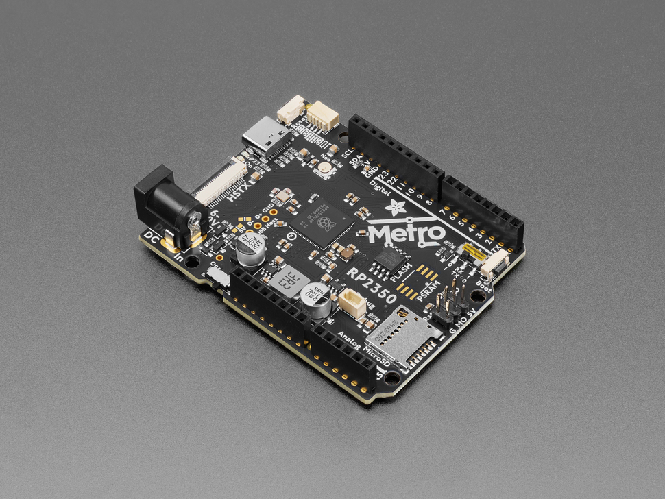

The Adafruit Metro RP2350 is an Arduino-compatible development board based on the Raspberry Pi RP2350 microcontroller. It features a dual-core ARM Cortex-M33 processor running at 150MHz, 528KB of RAM, and 16MB of QSPI flash for program storage.
The Adafruit Metro RP2350 is an Arduino-compatible development board based on the Raspberry Pi RP2350 microcontroller. It features a dual-core ARM Cortex-M33 processor running at 150MHz, 528KB of RAM, and 16MB of QSPI flash for program storage. The board operates at 3.3V logic and includes a 5V buck converter (TPS563201) that accepts a 4.5V to 17V DC input and provides up to 2A output.
It offers 37 available GPIOs, with 23 on the socket/SPI headers, 12 on the HSTX port, and 2 for USB host functionality. Six of these GPIOs also support analog input. The board includes a microSD card slot configured for SPI interfacing, with additional pins for SDIO, though SDIO support is not available in Arduino or Python. An onboard RGB NeoPixel is also included for status indication or visual feedback.
Designed for embedded development, the Metro RP2350 provides a familiar Arduino form factor with expanded I/O options and debugging capabilities. It supports programming in Arduino and CircuitPython, making it suitable for a range of applications requiring flexible connectivity and performance.

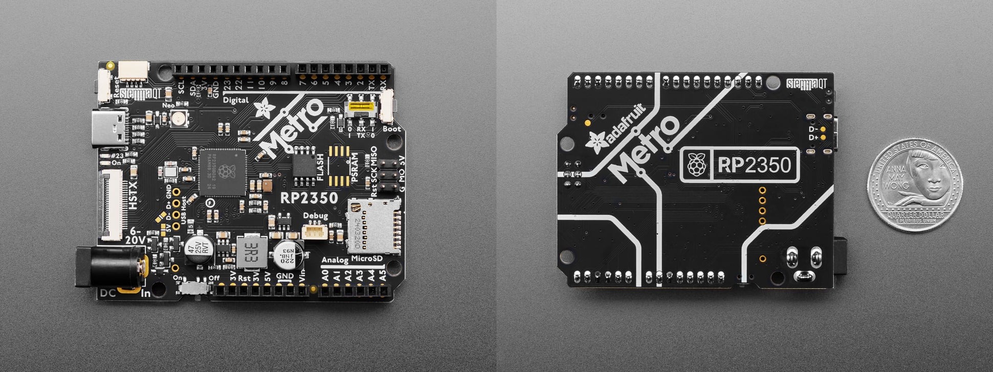

Adafruit Metro RP2350 front and back
