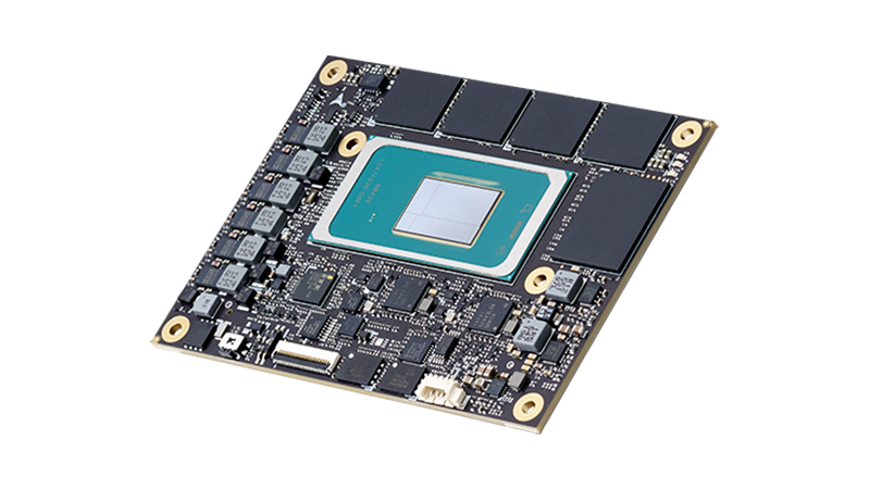

ADLINK has introduced the COM-HPC Mini Module, a compact computer-on-module based on Intel Core Ultra Series 3 “Panther Lake” processors. Designed for edge AI, robotics, machine vision, industrial automation, and embedded computing, the module delivers high AI performance in a 95 × 70 mm COM-HPC Mini form factor.
The COM-HPC Mini Module supports Intel Panther Lake-H processors up to the Intel Core Ultra X7 358H, featuring 16 hybrid CPU cores, Intel Arc Xe3 graphics, and an integrated NPU capable of delivering up to 50 TOPS. Combined with GPU acceleration reaching up to 122 TOPS, the platform offers as much as 180 TOPS of AI performance for demanding edge workloads. The module also integrates up to 64GB LPDDR5x memory, optional onboard NVMe SSD storage, and high-speed PCIe Gen5 and USB4 connectivity.

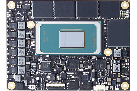

ADLINK COM-HPC-mPTL (Top)

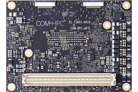

ADLINK COM-HPC-mPTL (Bottom)
