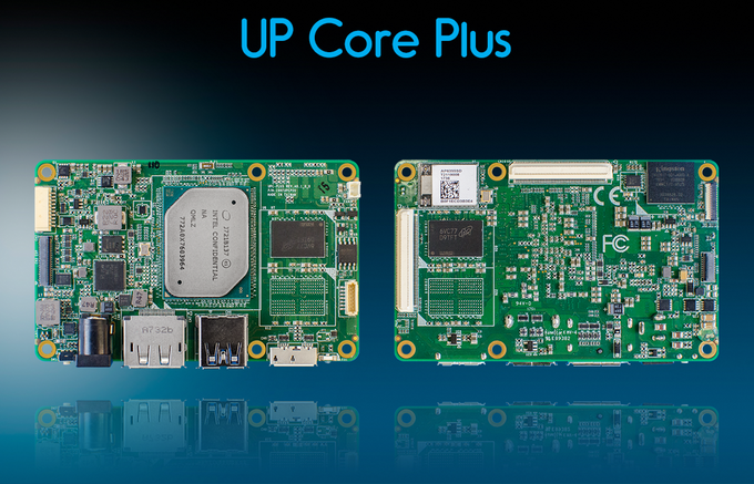

  • UP Core Plus: the credit-sized ( 56 x 90 mm ) board powered by Intel formerly known as Apollo Lake-I family, a 64 bit QuadCore Atom architecture with extremely high performance in only 9.5 W of TDP ( x5 – 3940). The board supports up to 8GB Dual Channel DDR4 2.400 MHz, DP up to 4K, eDP, 2 USB 2.0, 1 USB 3.0, 1 USB 3.0 OTG, WiFi 802.11 AC 2T2R, 2 x CSI and it has 2 x 100 pin high speed connector which bring to the carrier board I2C, I2S, ISH, UART, PCI-Express, USB 3.0 etc.

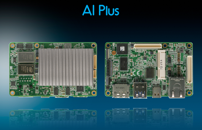

  • AI Plus: the credit-sized ( 56 x 90 mm ) companion board for UP Core Plus, powered by Intel® Cyclone® 10GX ( 105KLe-220KLe ) with 1 GB DDRIII, Display Port-IN connected to Cyclone 10gx for Video Acquisition, USB Type-C connector & GPIO connected to Intel Cyclone 10gx for data acquisition, LVDS-IN connected to Intel® Cyclone® 10GX for Camera acquisition natively compatible to Basler LVDS cameras, 1 GBit Ethernet, 1 USB 3.0 and mini-PCIe connected to UP Core Plus via the 100 pin high speed connector.

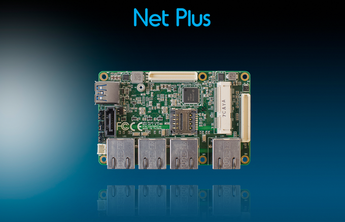

  • Net Plus: the credit-sized companion board of UP Core Plus which features 4 Full Gigabit LAN powered by Intel® I211AT ( option for I210 with support of TSN ), mPCIe to host either AI Core or 3G/4G modem, SATA, USB 3.0.

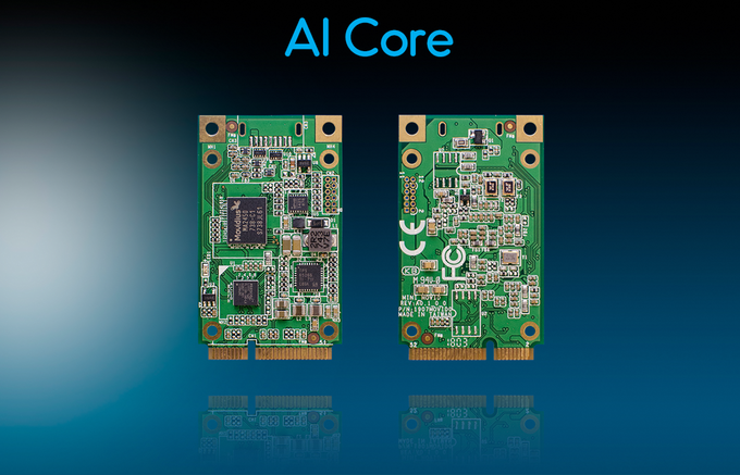

  • AI Core: the mini-PCIe module powered by Intel® Movidius™ MyriadTM 2 2450 with 512 MB DDR, the most advanced low-power technology for running deep learning and neural network on the Edge and processing video images.

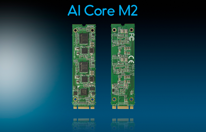

  • UP AI Core M2 is a M.2 2280 B+M key module which can be seamless integrated in most of the edge computers available on the market such the latest Intel NUC boards accelerating the path to production from lab to field installation. It is powered by two Intel® Movidius™ MyriadTM 2 VPU delivering double performance compared to single VPU solution.

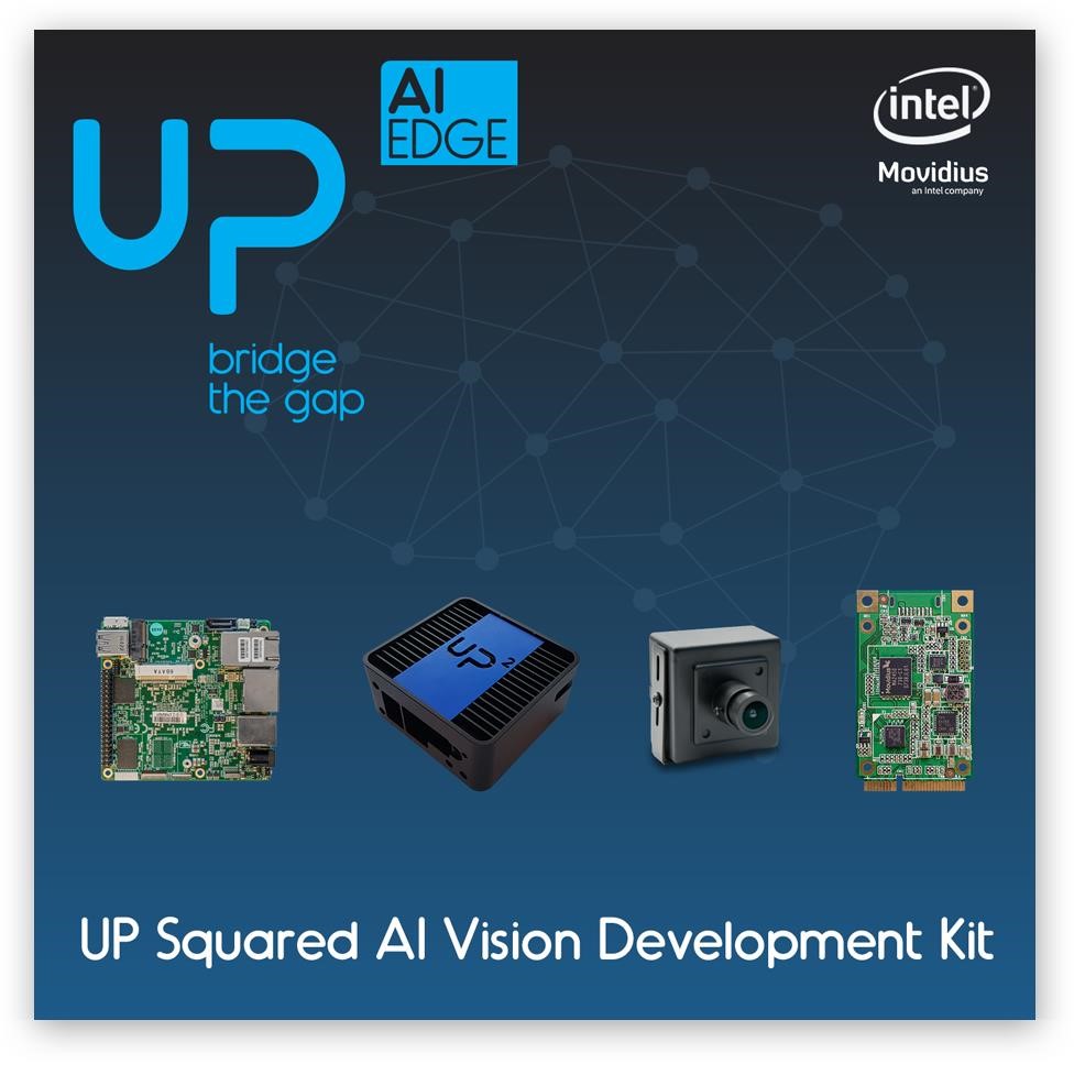

  •  UP Squared AI Vision Development Kit: UP Squared board powered by Intel x7-3950 SoC, 4GB memory, 64 GB eMMC with Ubuntu 16.04 image, a AI Core module, a UP HD camera, a fanless chassis and a power supply.
