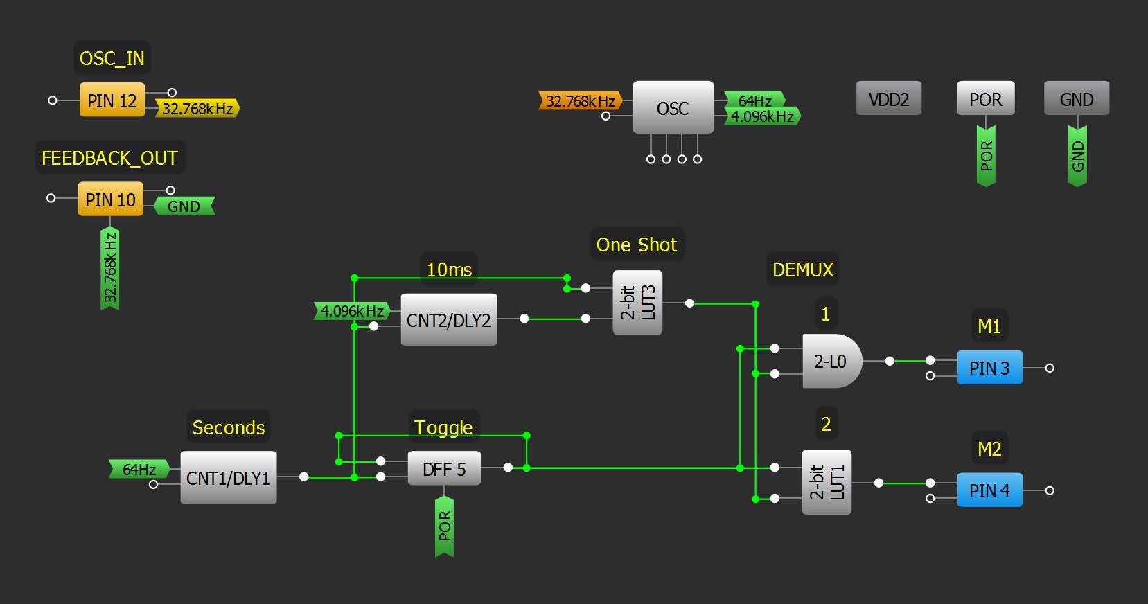

The attached design uses an SLG46121V to produce the required current waveforms through the stator coil. Separate 2x push-pull outputs on the IC (labeled M1 and M2) connect to each end of the coil and drive the alternating pulses. It is necessary to use push-pull outputs for this device to operate correctly.
The waveform consists of a 10 ms pulse each second, alternating between M1 and M2 with each pulse. The pulses are created with just a few blocks driven from a simple 32.768 kHz crystal oscillator circuit. The OSC block conveniently has built-in dividers to help divide down the 32.768 kHz clock. CNT1 outputs a clock pulse every second. This pulse triggers a 10 ms one-shot circuit. Two LUTs (labeled 1 and 2) demultiplex the 10 ms pulse to the output pins. Pulses are passed to M1 when DFF5 output is high, M2 when low.

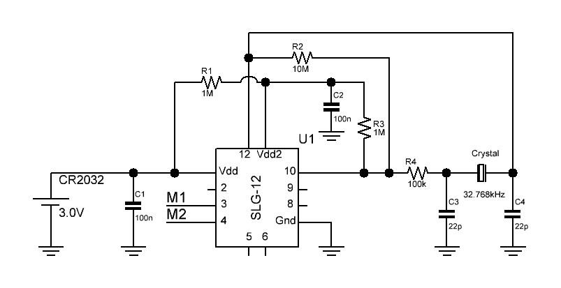

The 32.768 kHz crystal oscillator uses just two pin blocks on the chip. PIN12 (OSC_IN) is set as a low-voltage digital input (LVDI), which has a relatively low switching current. The signal from PIN12 feeds into the OE of PIN10 (FEEDBACK_OUT). PIN10 is configured as a 3-state output with input wired to the ground, making it act like an open drain NMOS output. This signal path naturally inverts, so no other block is needed. Externally, the PIN 10 output is pulled up to VDD2 (PIN11) by a 1MΩ resistor (R4). Both PIN10 and PIN12 are powered by the VDD2 rail, which in-turn is current limited 1 MΩ resistor to VDD. R1 is a feedback resistor to bias the inverting circuit, and R2 limits the output drive. Adding the crystal and capacitors completes the Pierce oscillator circuit as shown in Figure 3.
Figure 3: Circuit Diagram of External Connections

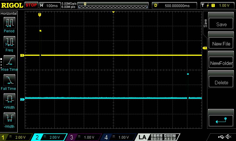

VDD was powered by a CR2032 lithium coin battery which typically provides 3.0 V (3.3 V when fresh). The output waveform consists of alternating 10 ms pulses as shown below in Figure 4. Averaged over a minute, the measured current draw was roughly 97 uA including the motor drive. Without the motor, the current draw was 2.25 μA.
Figure 4: Motor Driver Output Waveform, 10 ms on, 990 ms off
