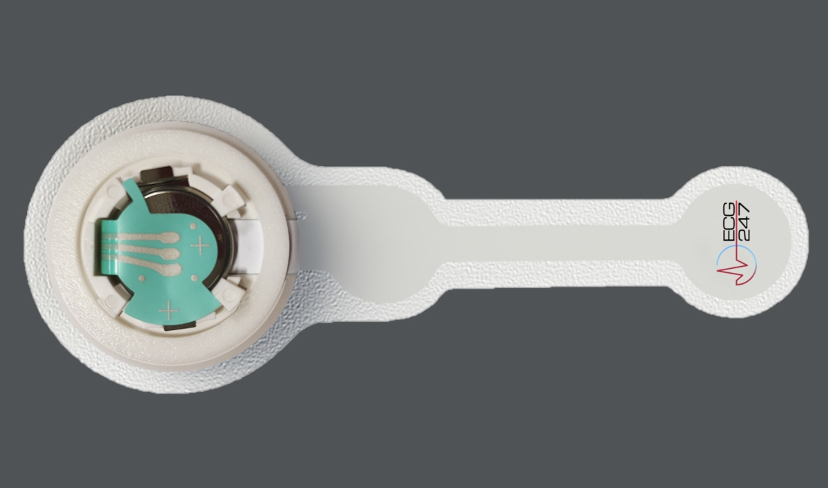

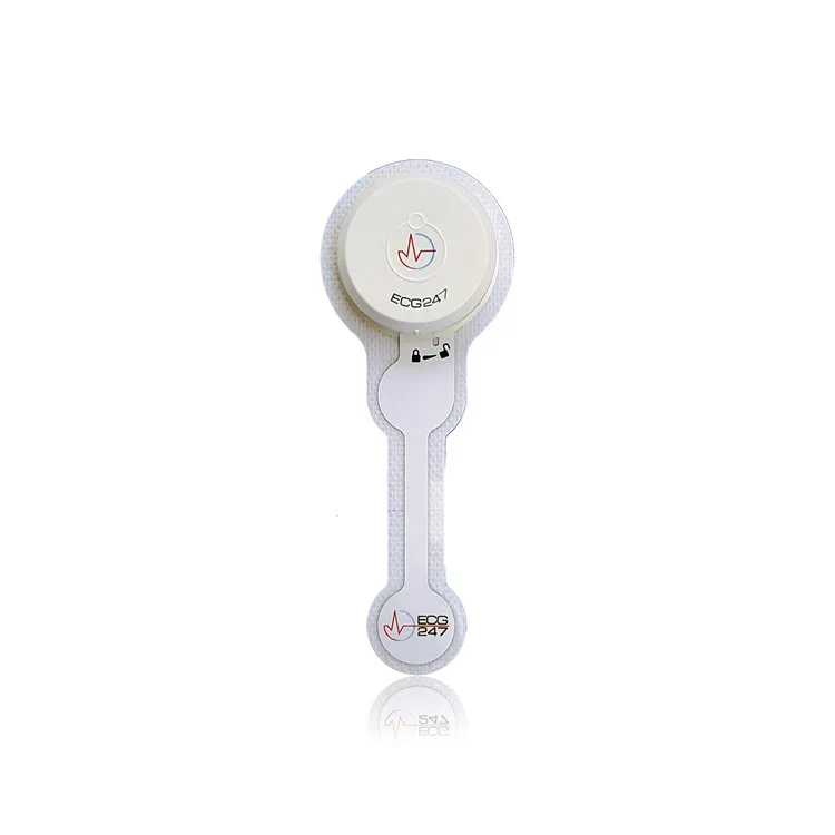

ECG247 Smart Heart Sensor has two parts – a disposable electrode-patch to fasten the sensor to the patient’s chest and a reusable electronic component for measuring the ECG signal. The patient can use this solution to self-diagnose their heart condition. This can also be used during exercise/physical activity.
The brain of this ECG247 Smart Heart Sensor is an nRF52832 SoC, based on a 64MHz, 32-bit ARM Cortex M4 processor with a floating-point unit (FPU). This processor is capable of handling the proprietory algorithm for continuously measuring and analyzing the electrical activity in the patient’s heart and detect any irregularity in the rhythm. Such complex algorithms need fast and accurate floating-point operations – here comes the powerful FPU of nRF52832. The nRF52832 is an ultra-low-power SoC that draws only a 5.5mA peak current while transmitting or receiving over the 2.4GHz band. This lets the patch run continuously for 14 days with a single CR2032 coin-cell battery.
