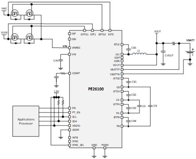

The PE26100 is a multi-level buck converter targeting direct battery charging in smartphones, tablets, and compact mobile devices. The device accepts input voltages from 4.5 V to 18.5 V, covering USB Power Delivery (USB-PD), programmable power supply, and Qi wireless charging sources.
Application circuit of the PE26100 multi-level buck converter for smartphones, tablets, and other mobile devices
Application circuit of the PE26100 multi-level buck converter for smartphones, tablets, and other mobile devices. Image used courtesy of pSemi
When a fixed USB-PD voltage is present, the PE26100 operates in four-level buck mode at higher input voltages and steps down to three-level buck mode at mid-to-low input voltages. The multi-level architecture reduces inductance requirements, enabling the device to deliver up to 6 A in a package under 1 mm tall — a practical advantage as smartphone and tablet designs continue to slim down.
For USB-PPS applications, where the source voltage is variable, the PE26100 can reconfigure itself as a switched-capacitor charge pump with divide-by-two or divide-by-three ratios. Multiple devices can be connected in parallel to increase the total charging current. The IC also supports reverse boost up to 10 W for on-the-go and reverse wireless charging scenarios.
On the protection side, the PE26100 includes input and output undervoltage lockout, overvoltage protection, overcurrent protection, and overtemperature monitoring with warning and fault status outputs. Current, voltage, and temperature telemetry is available over I2C. The part ships in a wafer-level chip scale package.

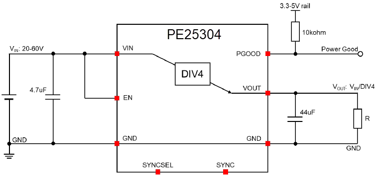

The second announcement is the PE25304, a charge pump switching‑capacitor power module built around 48 V power architectures. It accepts input voltages from 20 V to 60 V and divides the voltage by four, targeting the 48 V battery buses increasingly found in dexterous-hand robotics and mechatronic systems.
Circuit diagram of the PE25304 DC-DC converter module for step-down conversion applications
Circuit diagram of the PE25304 DC-DC converter module for step-down conversion applications. Image used courtesy of pSemi
The PE25304 delivers up to 72 W of output power in a 2 mm profile package and carries a rated conversion efficiency of 97%. In tightly packed robotic assemblies where thermal headroom is limited, efficiency matters — less power lost as heat means less thermal management overhead.
