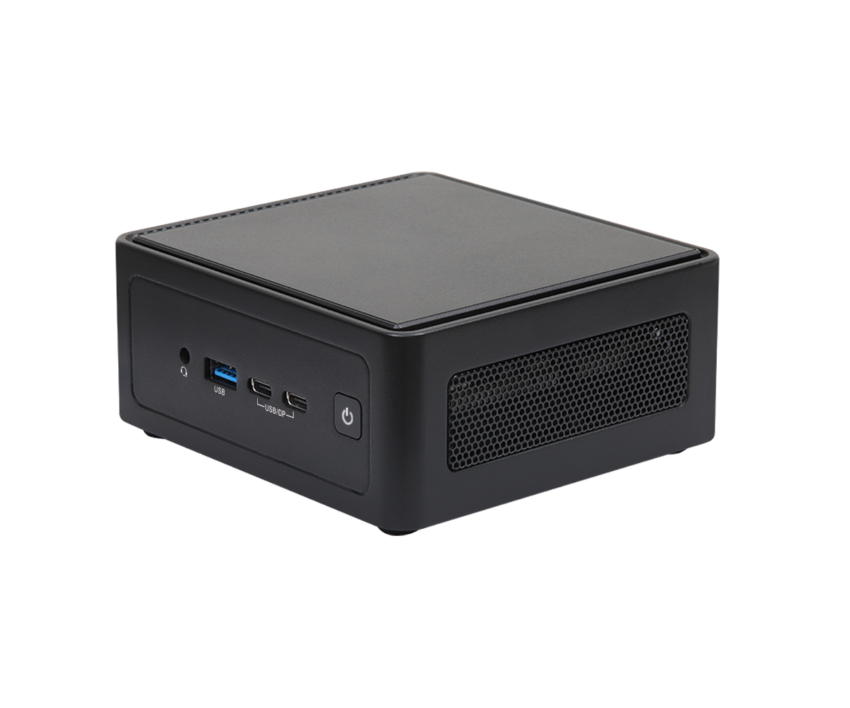

The 4X4 BOX 8040 Series’ enriched I/O connectivity in a compact size of 117.5 x 110 x 49 mm fanned barebone. With integrated AMD Radeon™ 700M Graphics, the Series supports 4K quad-display outputs through two HDMI 1.4b and two DisplayPort 1.4a (with two from Type-C), delivering marvelous visual experience. For dual-storage capabilities, the Series includes one M.2 (Key M, 2242/2280) and one M.2 (Key M, 2242) with PCIe Gen 4×4 for SSD ensuring maximum scalability. In addition, the 4X4 BOX 8040 Series is equipped with dual LAN ports- one 2.5G and one 1G port along with Wi-Fi 6E and Bluetooth 5.2 support to deliver high-speed communication. It also features two USB4, one USB 3.2 Gen2 (Type-A), and two USB 2.0 ports, accompanied by AMD firmware TPM for trusted security. With the 4X4 BOX 8040 Series, you can now seamlessly integrate limitless AI applications into your AI PC.
