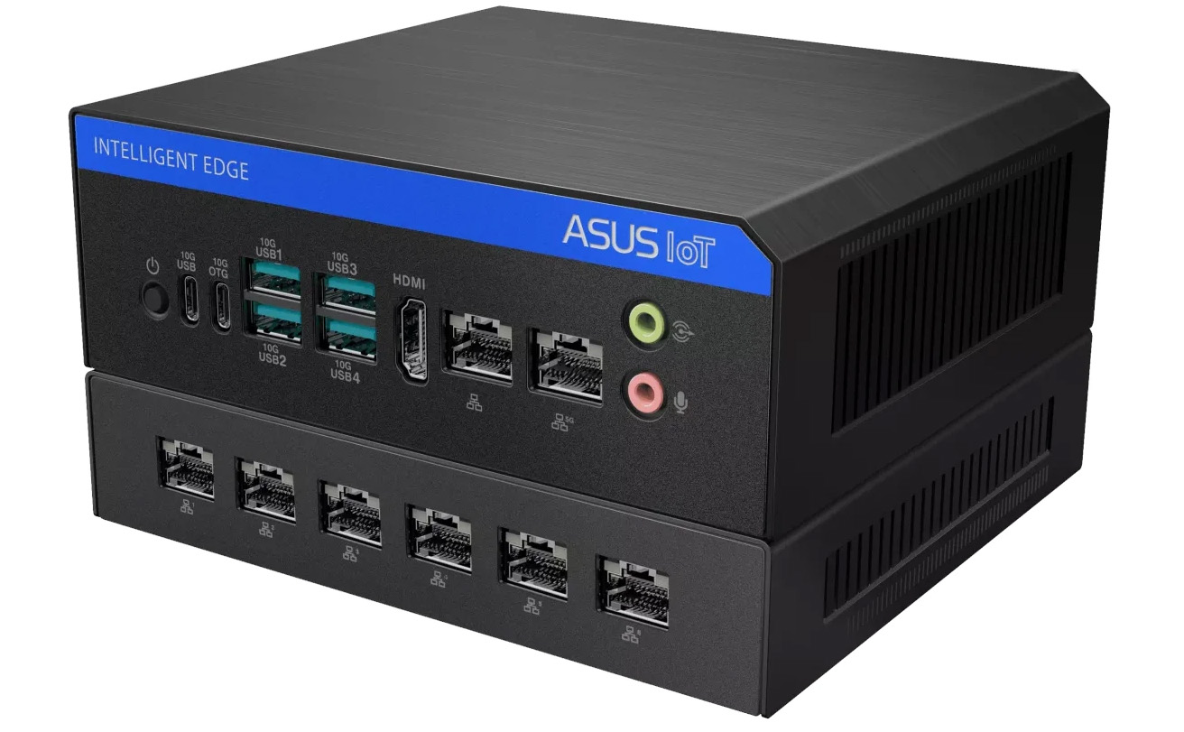

ASUS IoT PE3000N with 6 GbE PoE stack

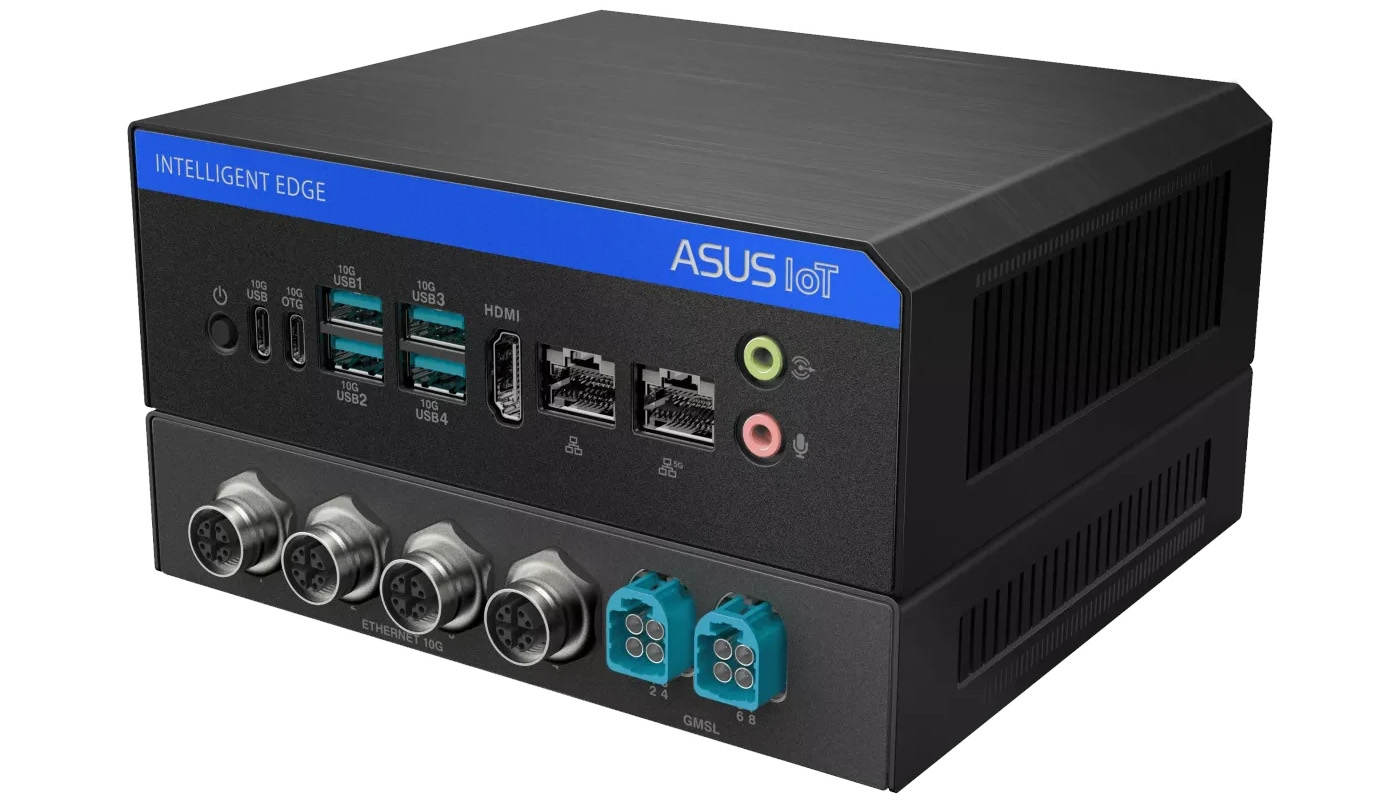

ASUS IoT PE3000N with 4x M12 10GbE PoE + 8x GSML stack
The ASUS IoT PE3000N features a modular, stackable design that lets users expand the system with optional base units. Available stacks include a six-port GbE/PoE module and a high-speed module with four 10GbE M12 ports plus dual Fakra connectors for up to eight GMSL cameras, with custom stack configurations also supported.
