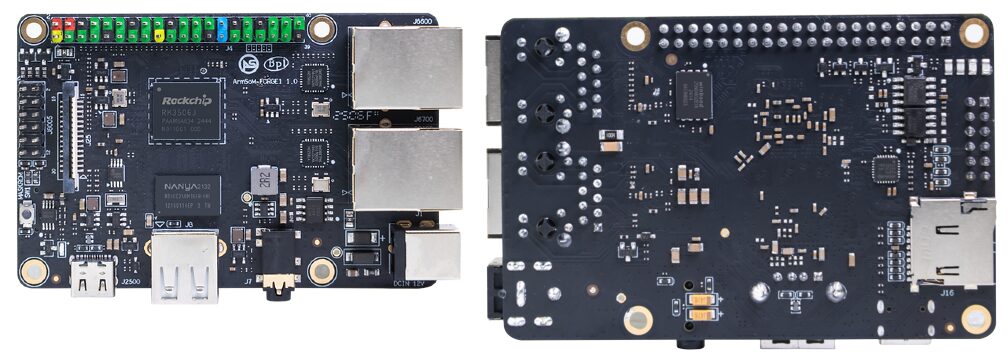

ArmSoM Forge1 SBC Features Rockchip RK3506J SoC with Cortex-A7/M0 Cores for Industrial and Audio Applications
ArmSoM Forge1 is an industrial-grade single-board computer (SBC) built for embedded applications such as smart audio systems and factory automation. It is based on the Rockchip RK3506J system-on-chip, which integrates a triple-core Arm Cortex-A7 CPU running at up to 1.5GHz along with an Arm Cortex-M0 core for real-time control tasks.
The board comes with 512MB of DDR3L memory and 512MB of SPI NAND flash, and also includes a MicroSD card slot for external storage. It supports display output through a 2-lane MIPI DSI connector, capable of driving 1280×1280 resolution at 60fps. Audio input and output are accessible via dedicated expansion headers.
For networking, the Forge1 offers dual 100Mbps Ethernet ports. A USB Type-C port is used for both power input and programming, while a USB 2.0 host port supports external peripherals. The SBC includes a 40-pin GPIO header compatible with Raspberry Pi HATs, providing access to UART, SPI, I2C, I2S, and PWM. An additional 12-pin header exposes interfaces for speaker, microphone, RS-485, and CAN Bus, making the board suitable for industrial communication and control tasks.
ArmSoM Forge1 RockChip RK3506J SBC front and back
