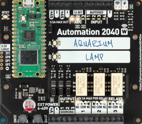

UK-based Pimoroni has designed an all-in-one Automation 2040 W monitoring and automation system based on the Raspberry Pi Pico W development board module. As a standalone affair with pre-soldered Pico W, 2.4 GHz WiFi 4 wireless connectivity, and an extended voltage range of 6 to 40V, the Automation 2040 W seems to set the pace for other home automations boards that we have seen.
The board is equipped with rich interfaces and components such as relays, analog channels, powered outputs, and buffered inputs. 4x digital inputs and 3x 12-bit analog inputs are located along its top while 3x relays and 3x sourcing outputs providing up to 40V for things like pumps and larger motors are located at its bottom. Other features include 2x user buttons, 1x reset button, 2x Qwiic/STEMMA QT connectors for breakout sensors, an unpopulated header, and one status LED wired directly for every input and output so you can see when it’s active at a glance.
The board is tolerant from 6V all the way up to 40V, and compatible with 12V, 24V, and 36V systems for all your home automation needs. It can also provide 5V outputs for lower-voltage applications.
The Automation 2040 W board can be used to control fans, pumps, solenoids, larger motors, electronic locks, etc. It comes fully assembled and requires no soldering.

  • Built-in Raspberry Pi Pico W with:
    • Raspberry Pi RP2040 dual-core Cortex-M0+ microcontroller @ 133 MHz with 264KB SRAM
    • 2MB QSPI flash memory
    • 2.4GHz wireless
    • 1x micro USB for power and programming
  • 3x 12-bit ADC inputs up to 40V
  • 4x Digital inputs up to 40V
  • 3x Digital sourcing outputs at V+ (supply voltage)
    • Max continuous current 4A
    • Max current of 2A at 500Hz PWM
  • 3x relays supporting 2A up to 24V, 1A up to 40V
  • 3.5mm screw connectors for inputs, outputs and external power
  • 5-pin header with 3x GPIO, 3.3V and GND
  • 2x Qw/ST ports
  • 2x LED indicator buttons
  • Reset Button
  • WiFi and Power LEDs
  • M.25 Mounting holes
  • Power:
    • Requires 6 to 40V supply via screw terminals
    • Can supply 5V up to 0.5A for applications needing lower voltage
    • Board is compatible with 12, 24, 36 V systems
  • Dimension: TBD
  • OS: C++/Micropython
