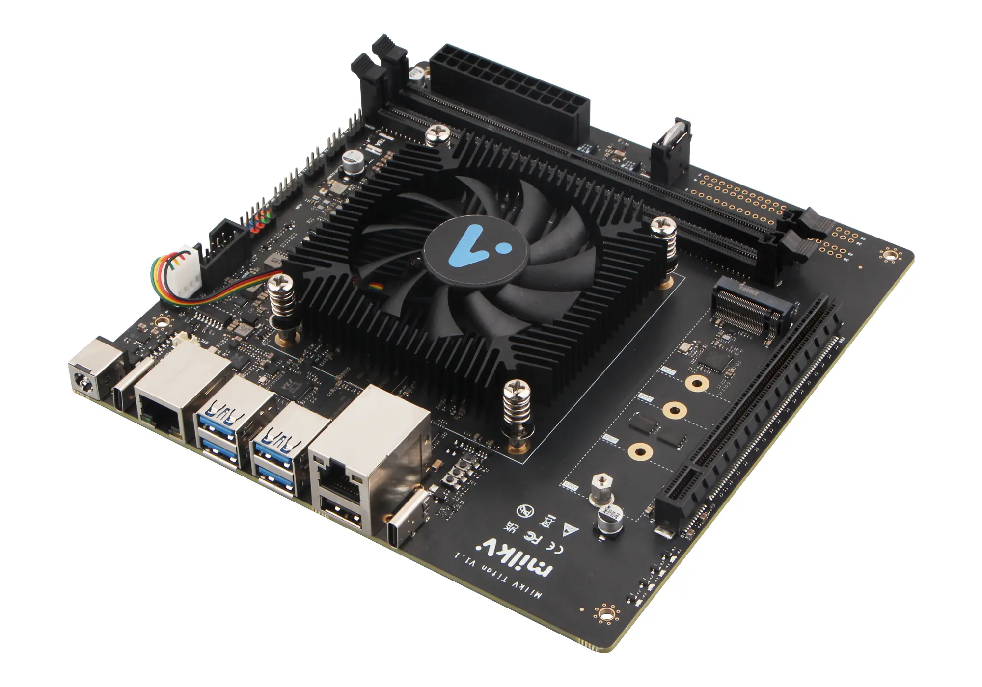

Milk-V Titan mini ITX RISC-V motherboard
The Milk-V Titan is a high-performance mini ITX RISC-V motherboard designed to bridge the gap between experimental hardware and mainstream desktop computing. Measuring a standard 170 x 170 mm, this board fits seamlessly into a vast ecosystem of PC cases and components, making it an ideal choice for edge computing and lightweight server applications. At its heart lies the 2 GHz UltraRISC UR-DP1000 octa-core CPU, featuring an RVA22/RVA23-compliant architecture and 16 MB of total L3 cache. This powerful configuration offers enthusiasts and developers a robust platform for testing the future of open-standard processing in a familiar, compact form factor.
Engineered for versatility, this mini ITX RISC-V motherboard supports up to 64 GB of dual-channel DDR4 ECC RAM, ensuring stability for professional workloads. Connectivity is a major highlight, featuring PCIe Gen4 x16 for discrete GPUs or AI accelerators, M.2 NVMe storage, and dedicated BMC ports for out-of-band management. Whether powered via a standard ATX supply for heavy loads or a DC5525 jack for lighter tasks, the Milk-V Titan provides a comprehensive hardware solution for those looking to deploy high-performance RISC-V architecture in modern desktop environments.

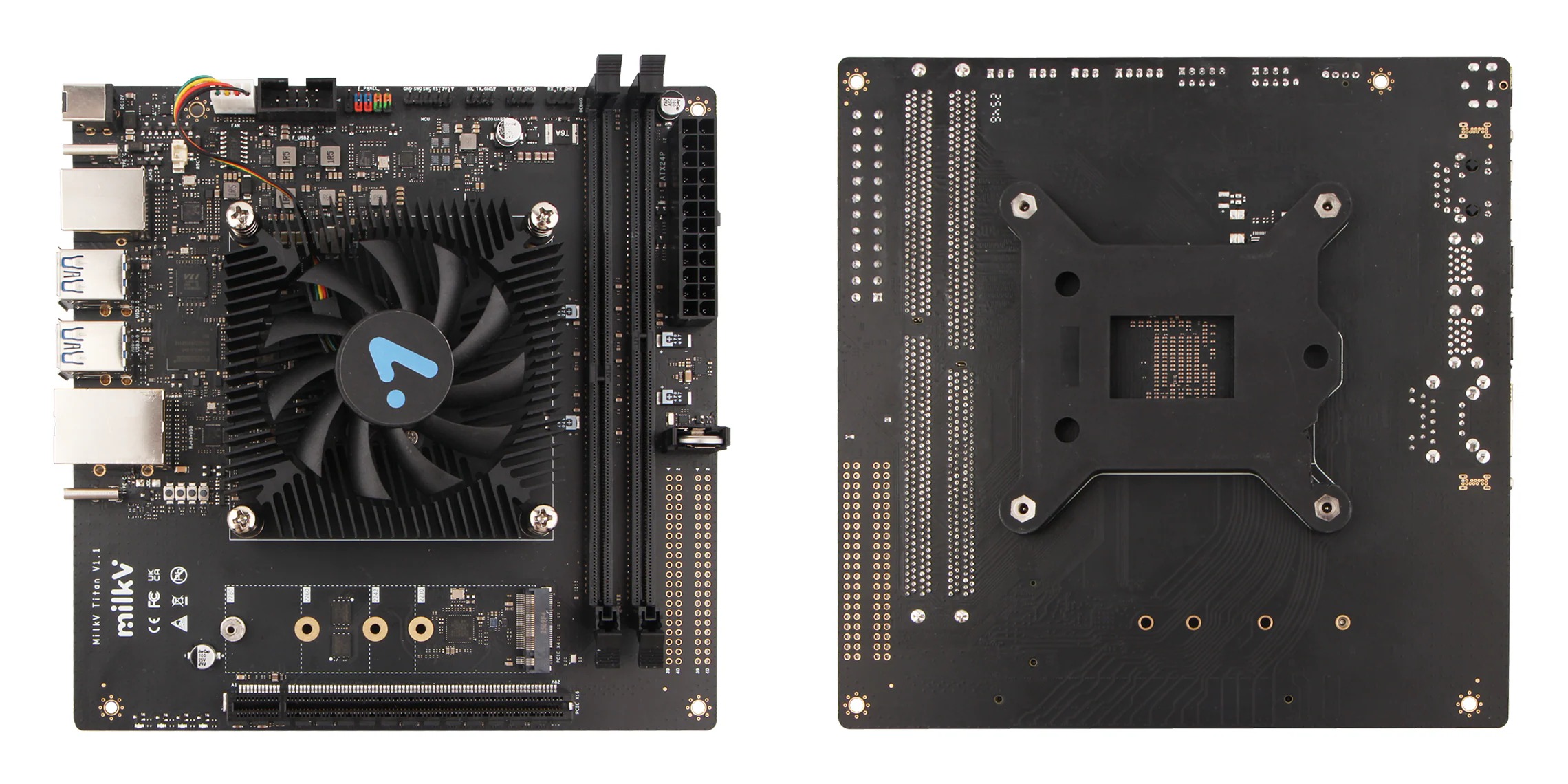

Milk-V Titan mini ITX RISC-V motherboard Front and Back Side

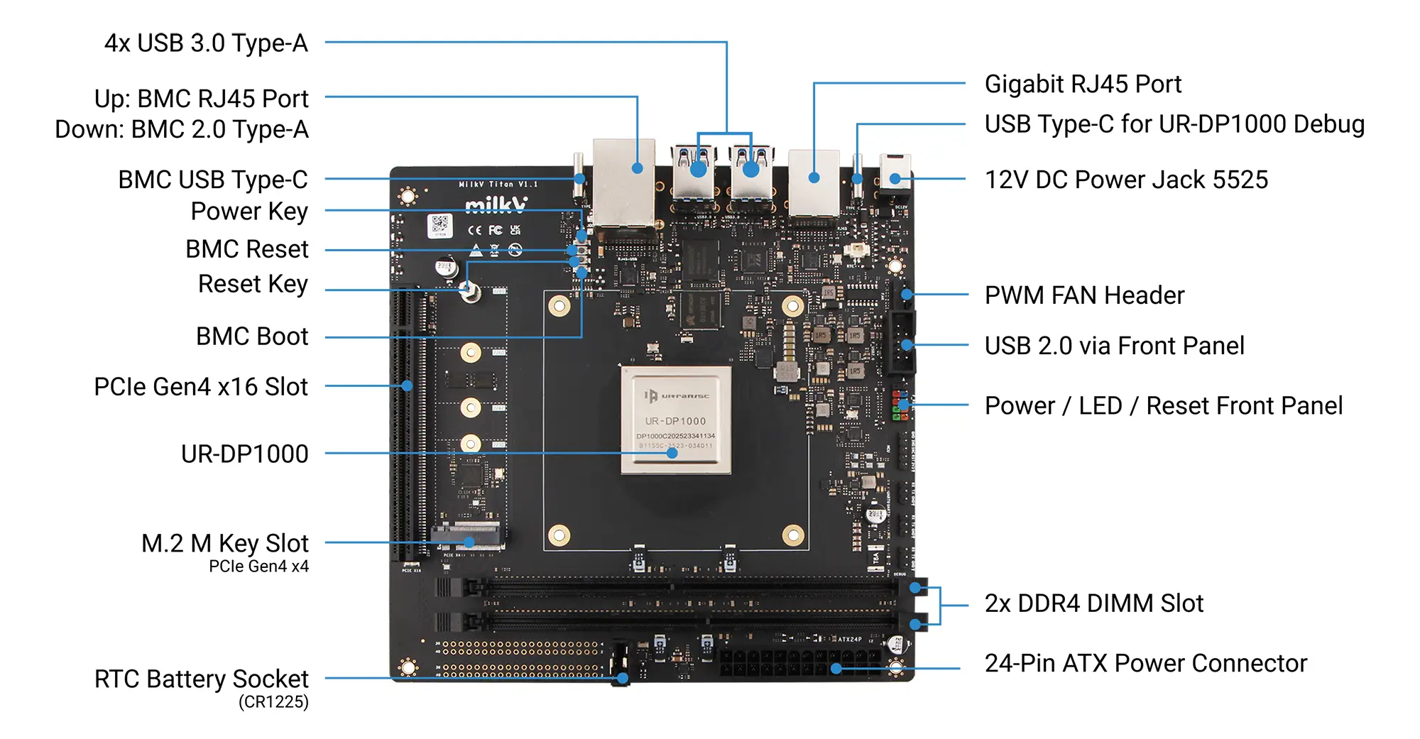

MILK-V Titan Hardware Interface
