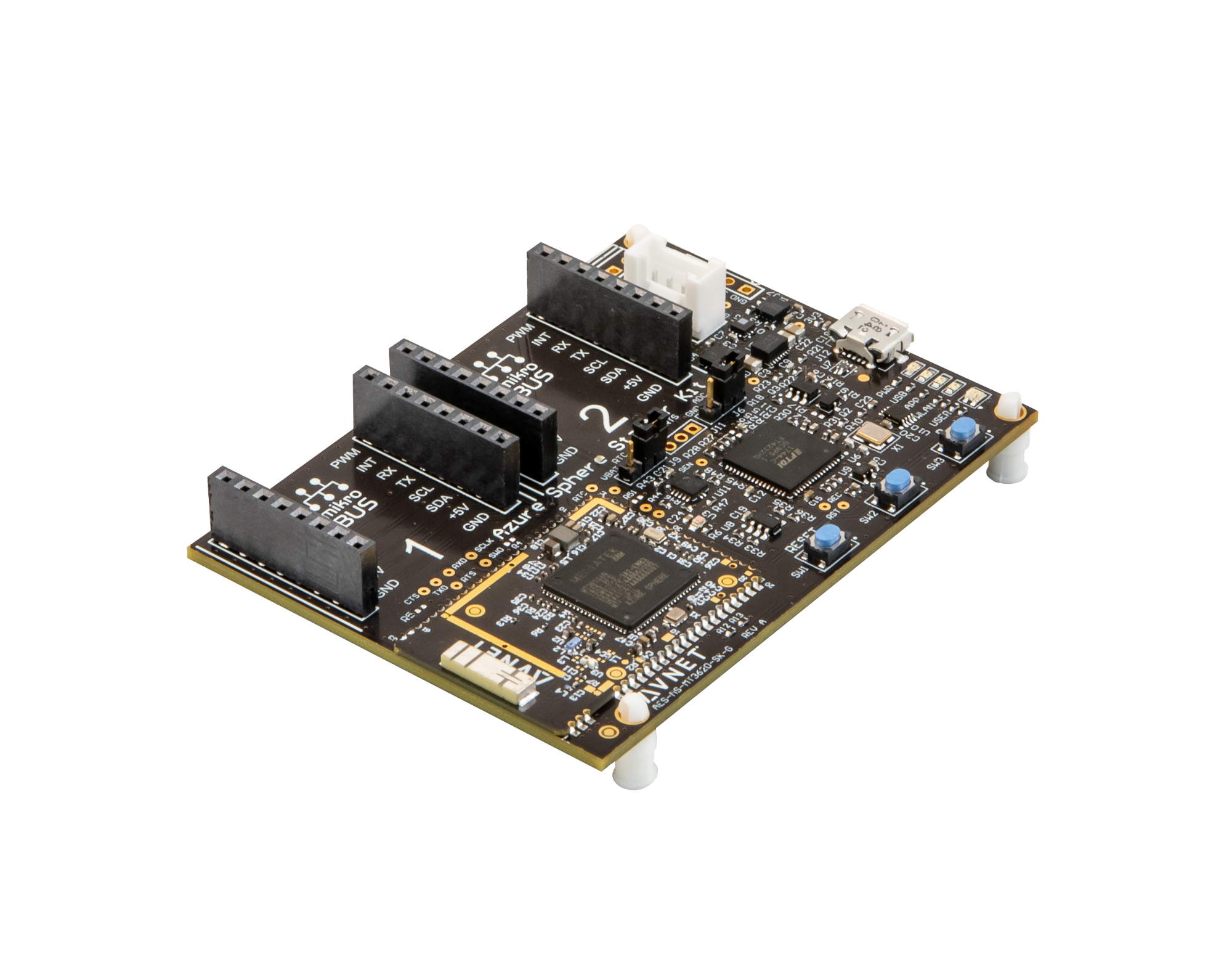

The starter kit launched is built around the Avnet Azure Sphere module which is based on the MT3620 reference development board. The MT3620 is a highly integrated, high-performance IoT MCU with the high level of security necessary for modern, robust internet-connected devices. The MT3620 targets a wide range of IoT applications including smart home, commercial, industrial and many other domains thanks to its extensive I/O peripheral subsystem that allows device design flexibility and freedom.
The starter kit can easily find application in the below markets:
  • Consumer appliances
  • Smart retail.
  • Remote access
  • Building automation software.
  • Factory automation applications.
Specifications:

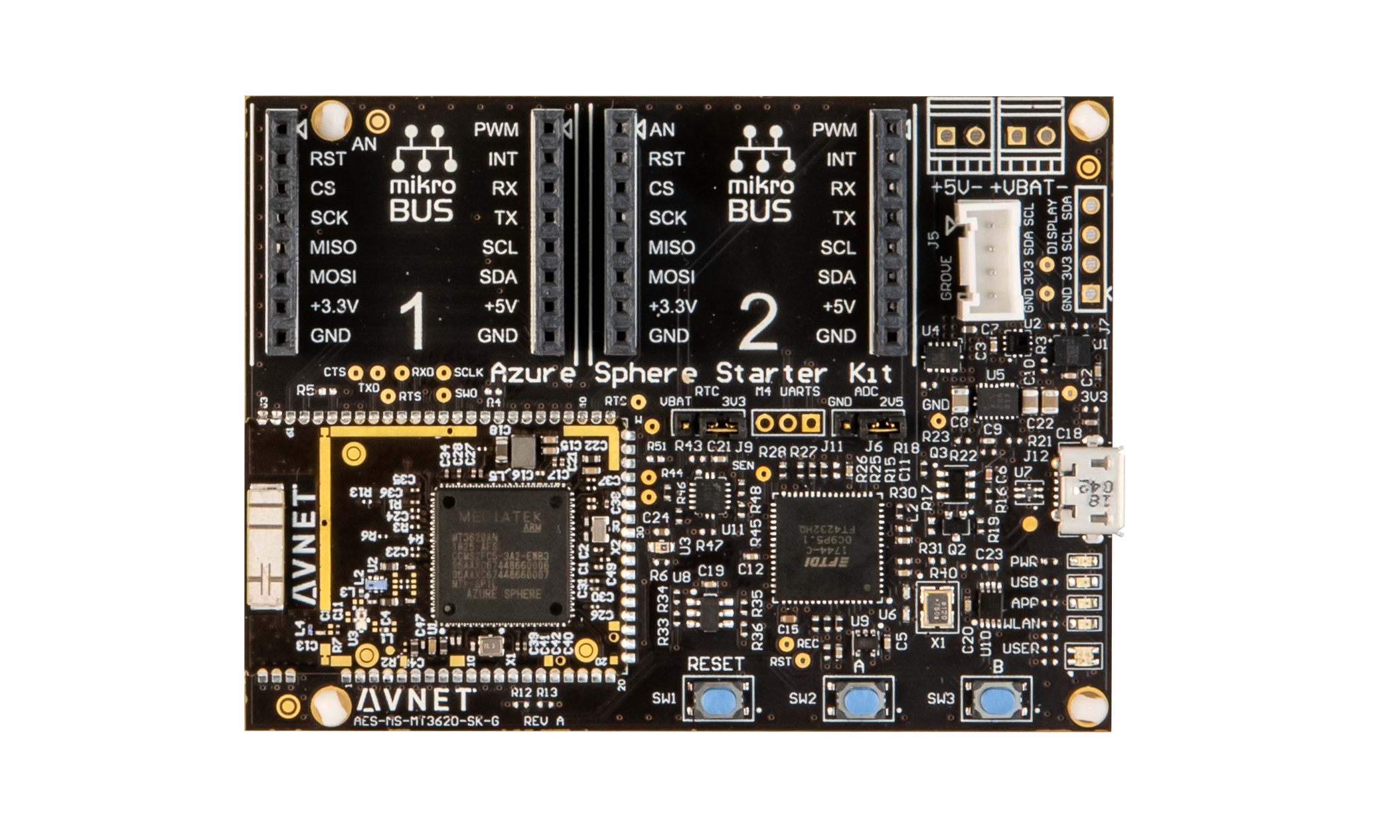

  • Two MikroEClick Board expansion sockets
  • Built-in Microsoft security.
  • Connectivity: Wi-Fi.
  • Processor: Arm Cortex-A7
  • Grove expansion connector (I2C)
  • Onboard sensors
  • 3-Axis accelerometer
  • 3-Axis Gyro
  • Temperature
  • Pressure/Barometric
  • Interface for optional OLED 128×64 display
  • USB Interface
  • Supports debug, service and recovery UARTs, and JTAG
  • User push switches and LEDs
  • 5V to 3.3V Power regulation
  • DC Supply Input:
  • USB 5V from the host computer
  • Terminal footprints for external 5VDC and VBAT supplies

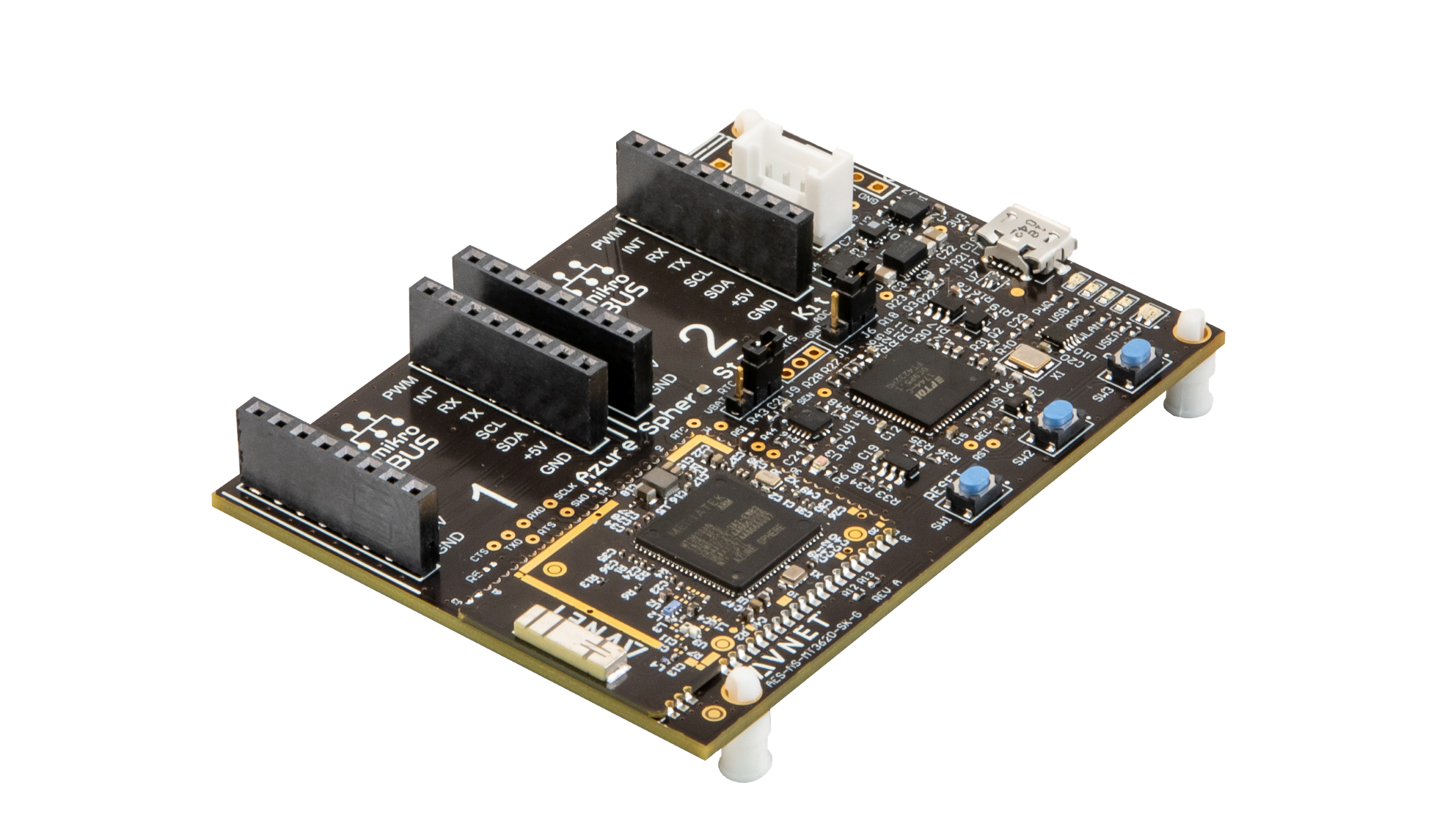

  • Azure Sphere MT3620 Module features include:
  • MediaTek MT3620AN SoC
  • 3x ISU interfaces pre-configured for UART, SPI, I2C
  • ADC/GPIO: 3x 12-bit ADC inputs (or 3 GPIOs)
  • PWM/GPIO: 9x PWM outputs (or up to 24 GPIOs)
  • RTC (requires VBAT supply)
  • Dual-band 2.4/5GHz 802.11 a/b/g/n WiFi
  • Dual-band 2.4/5GHz chip antenna
  • Production-ready
Azure Sphere MT3620 module is a 33 x 22 mm module and packs a dual-band Wi-Fi chip antenna and a system clock. It provides support of up to 27 configurable GPIOs, including support for UART, I2C, and SPI.
The MT3620 starter kit includes a carrier board that connects the Azure Sphere MT3620 module I/Os to a pair of MikroE sockets, I2C grove connector, OLED graphical display connector, 3D accelerometer & gyro, temperature and light sensors. All of this together, when put in order, the connected device in harmony with each other will give the best of their results. A 5 V power is applied to the board, due to the in-built debugging. Debugging is achieved through USB to UART interface.
