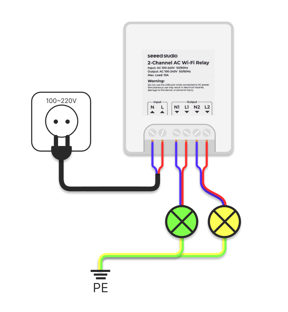

    • Terminals: Neutral (N), Live (L)
    • Input voltage: 100-240V AC, 50/60Hz
  • Power Output:
    • Terminals:
      • Channel 1: N1 (Neutral), L1 (Live)
      • Channel 2: N2 (Neutral), L2 (Live)
    • Output voltage: 100-240V AC, 50/60Hz
