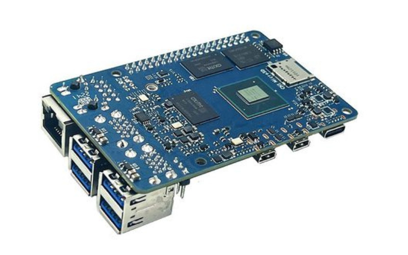

Banana Pi has introduced a single-board computer, BPI-M6, based around the Synaptics VS680 quad-core Arm Cortex-A73 and an Arm Cortex-M3 processor. The board is the next-generation single-board computer from Banana Pi in 2022, which integrates a GE9920 graphics processing unit and a neural processing unit with up to 6.75 TOPS performance.
Banana Pi BPI-M6
Banana Pi has introduced a single-board computer, BPI-M6, based around the Synaptics VS680 quad-core Arm Cortex-A73 and an Arm Cortex-M3 processor. The board is the next-generation single-board computer from Banana Pi in 2022, which integrates a GE9920 graphics processing unit and a neural processing unit with up to 6.75 TOPS performance. The manufacturer has provided onboard 4GB LPDDR4 memory and 16GB eMMC storage.
Inside the Banana Pi BPI-M6 single-board computer is the Synaptics VideoSmart VS680 edge computing system-on-chip that combines CPU, NPU, and a GPU. The module is capable of neural network acceleration with purpose-built for perceptive intelligence for applications such as smart displays, smart cameras, and media streaming. The company claims the VS680 system-on-chip to be a multimedia powerhouse that supports a Qdeo 4K video engine, an audio processor capable of far-field keyword detection and voice recognition, and a proprietary SyNap deep learning accelerator (DLA).

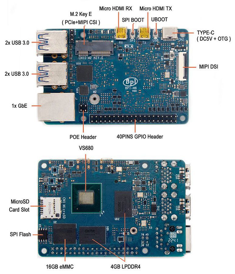

Specifications of Banana Pi BPI-M6 single-board computer:
  • System-on-chip: Synaptics VideoSmart VS680
  • Processor: A quad-core Cortex-A73 and a Cortex-M3 processor core
  • GPU: Imagination GE9920 GPU
  • NPU: For artificial intelligence up to 6.75 TOPS
  • Memory: 4GB LPDDR4
  • Storage: MicroSD slot with suppor1t for up to 256GB expansion and 16G eMMC flash with support for up to 64GB
  • Network interfaces: 10/100/1000 Mbit/s Ethernet, optional Wi-Fi USB dongle
  • Video interfaces: 1x HDMI 2.1 and 1x HDMI in port
  • Audio interface: 1x HDMI digital output
  • Display: MIPI-DSI
  •  GPIOs: 40-pin header
  • Switches: SPI boot and U-boot
  • LEDs: Power status and activity status
  • Power: 5V@3A Type-C
  • Dimensions: 92×60 mm
  • Weight: 48 grams
  • Operating system: Android and Linux
