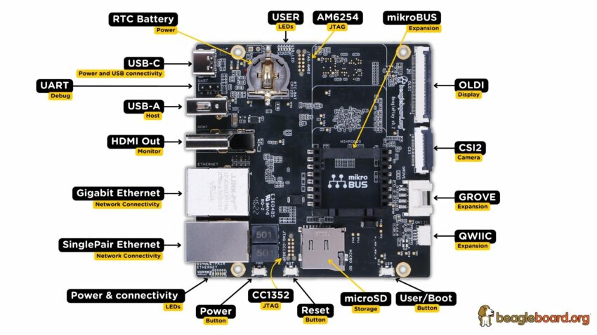

BeaglePlay utilizes an open-source Linux approach based on the Texas Instruments AM625 processor that features four 64-bit Arm Cortex-A53 processor cores and low-latency microcontroller subsystems. The processor also includes a dedicated Texas Instruments SimpleLink CC1352P7 sub-1 GHz and 2.4-GHz wireless microcontroller and a Texas Instruments WiLink WL1807MOD Wi-Fi module.
BeaglePlay comes with a tailored Debian Linux image from the BeagleBoard Foundation that includes a pre-installed desktop and features such as a Wi-Fi access point and BeagleConnect gateway functionality allowing rapid and flexible development options. Additionally, the software supports several application libraries and examples from Linux, Zephyr, MicroPython, and other open-source frameworks, making it effortless for users to incorporate various features into their projects.
Specifications of BeaglePlay hardware device
  • Processor: Texas Instruments AM62x Sitara processor series– TI AM6254 multicore A53 with R5, M4s and PRUs
  • Integrated power management: TPS6521901
  • Memory: 2GB DDR4 memory
  • Storage: 16GB eMMC and microSD card slot
  • Wireless connectivity: WL1807MOD module for 2.4GHz and 5GHz dual-band Wi-Fi and CC1352P7 for Bluetooth Low Energy
  • Ethernet: Realtek RTL8211F-VD-CG gigabit Ethernet phy
  • Interfaces: USB Type-C, HDMI port, mikroBUS connector, Grove, QWIIC, CSI connector, and an OLDI connector
