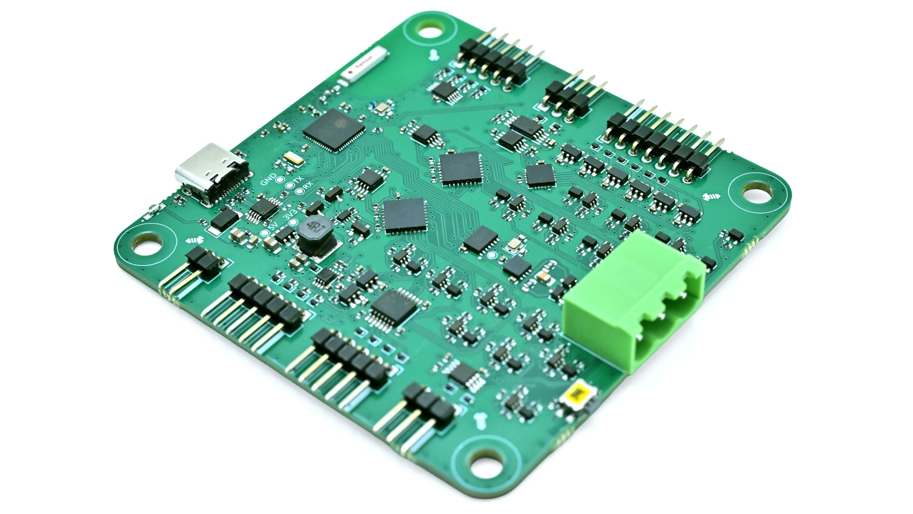

The internal PCB of the bUniProbe hardware debugger

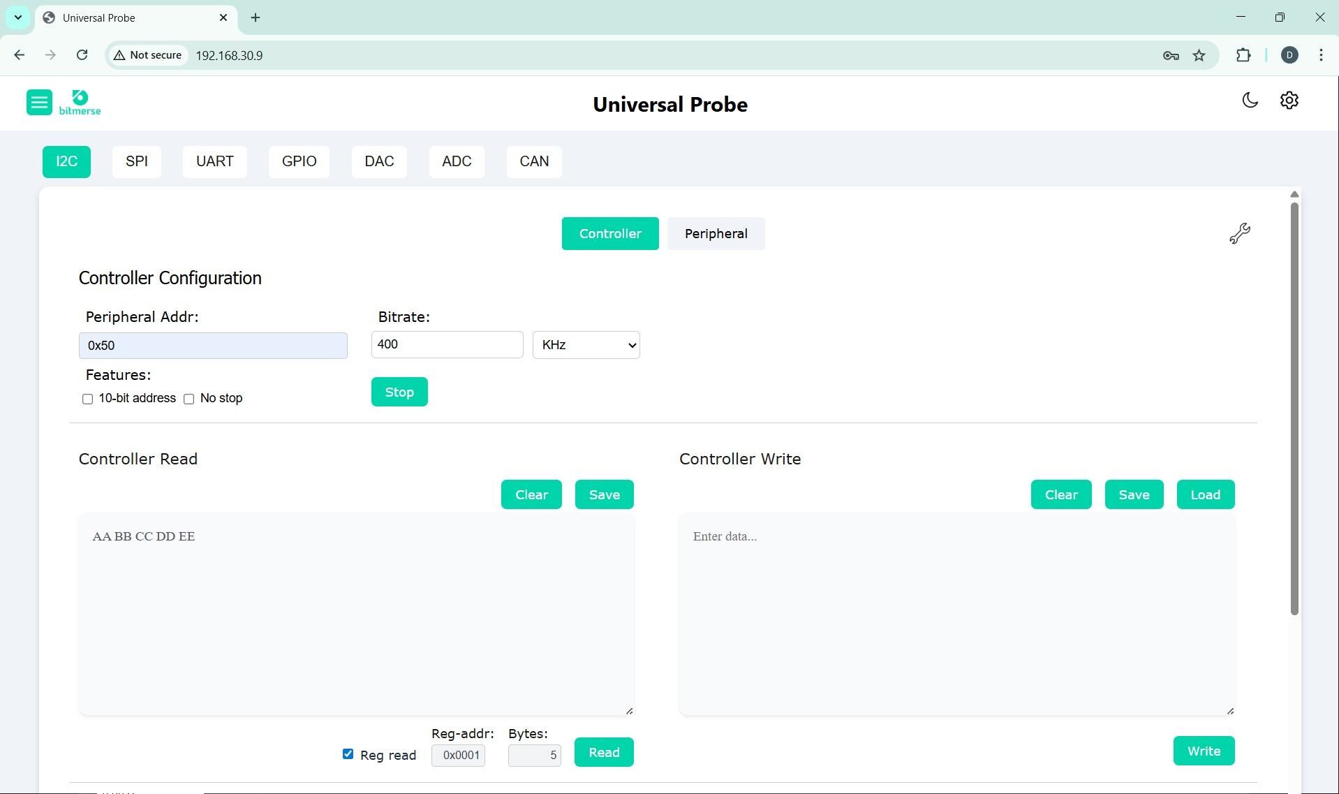

The device gets connected to your Wi-Fi router, and its built-in web interface can be accessed via a browser to send and receive data through dedicated panels. There is also a built-in waveform viewer for real-time monitoring of both digital and analog signals. Since it connects over Wi-Fi, the webpage can be accessed from multiple devices simultaneously, making collaborative debugging easier than with typical USB-based tools. The platform also exposes REST APIs, allowing developers to automate tests or build custom tools using Python or any language that supports HTTP requests.
The browser-based user interface for the bUniProbe, showing the I2C communication and configuration panel
