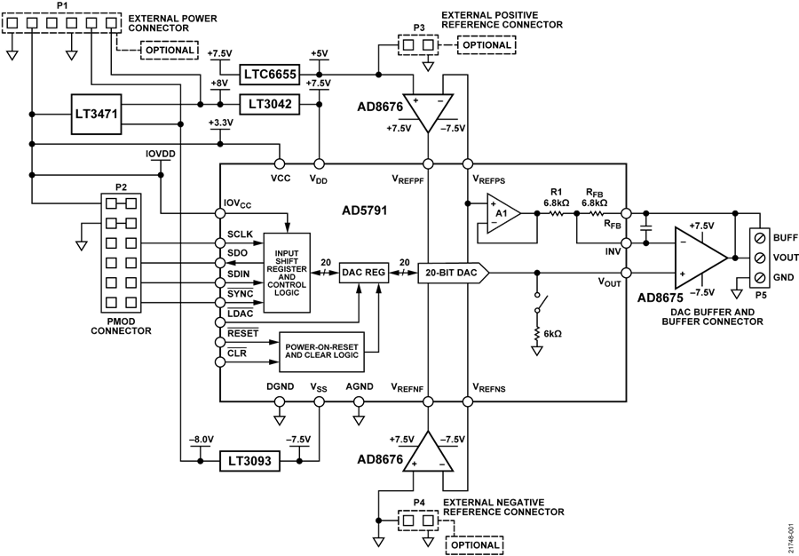

The circuit shown in Figure 1 is a programmable 20-bit voltage source that enables these demanding applications. The output range is −5 V to +5 V with ±1 LSB integral nonlinearity (INL), ±1 LSB differential nonlinearity (DNL), and exceptionally low noise and low drift across the entire output range.
On-board power converters produce the required supply rails from a single voltage supply provided by the development platform board. Low noise, high power supply rejection ratio (PSRR) voltage regulators ensure that the switching noise is minimized. A high precision, high stability, on-board hermetically sealed voltage reference ensures the high precision and accuracy of the 20-bit system.
Features:
  • +/-5V Output Range
  • 20-Bit Signal Generation Control
  • On board precision 5V Reference
  • All Power Rails Generated Using a Single 3.3V Source
The output of the circuit is a buffered voltage with an option for a remote sense connection to compensate for lead resistance or allow for the insertion of an external power stage, if necessary, providing drive flexibility for the desired end application.
