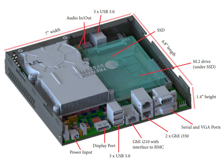

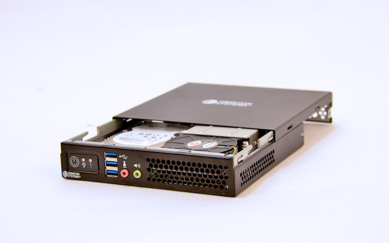

Trenton Systems has released a photo and preliminary documentation for an Ion Mini PC due to begin sampling by the end of the month. Although this Mini-ITX-based, 178 x 173 x 36mm system is a bit larger than what we typically consider to be a mini-PC these days, it packs in a lot of features including 6x USB 3.0 ports and a Gigabit Ethernet port linked to a Baseboard Management Controller (BMC) chip for remote, out-of-band management of network connections.
The Ion Mini PC supports up to 32GB of dual-channel DDR4-2400/2666, including ECC RAM. There’s an internal 2.5-inch SATA SSD drive and an M.2 slot (x4 PCIe) with NVMe storage support.
Other features include 6x USB 3.0 ports, a DisplayPort, and VGA and RS-2332 (DB9) ports. You also get include dual audio jacks, a power button and jack, and an LED.
The two standard Gigabit Ethernet ports use Intel i350 controllers while the BMC-linked GbE has an Intel i210. The port is monitored by an AST2500 Baseband Management Controller consisting of rKVM, system monitoring, out-of-band management, and a TPM 2.0 security chip. A customizable in-house BIOS is also available. The system supports 0 to 50°C temperatures with 5% – 90% non-condensing humidity tolerance.
