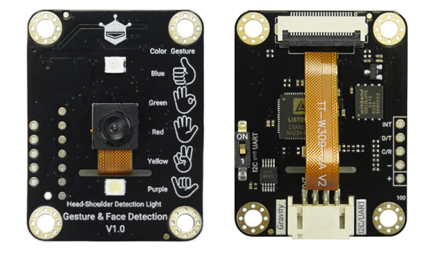

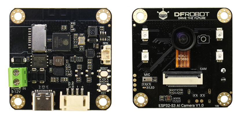

The Gravity sensor detects 5 hand gestures and up to 10 faces or upper-body presences within 3 meters, while the ESP32-S3 AI CAM adds voice control, night vision, and Wi-Fi/BLE connectivity, making them useful for privacy-focused IoT use such as smart homes, kiosks, or automation systems.
The Gravity sensor runs AI locally with I2C/UART support, 3.3–5V input, 100mA typical draw, and real-time RGB gesture indicators. The ESP32-S3 CAM features a 3MP IR wide-angle camera, onboard mic, speaker amp, ChatGPT voice interaction, and supports EdgeImpulse, YOLO, and OpenCV. It includes IR LEDs, a light sensor, an SD slot, and runs on 3.3V or 5–12V via USB/Type-C. Both modules offer fast, local AI processing without cloud reliance.

  • Gravity: Offline Edge AI Gesture & Face Detection Sensor
    • MCU – Espressif ESP32-S3R8 dual-core Xtensa LX7 processor with AI acceleration
    • Recognition Capabilities
      • Gesture Recognition: 5 predefined hand gestures
        • Thumbs up
        • Index + middle fingers
        • ️ Open palm
        • Thumb + little finger
        • Middle, ring, and little fingers
      • Face and Upper Body Detection
      • Recognition Range:
        • Gesture: 0.5 to 3 meters
        • Face/Body: 0.5 to 3 meters
      • Field of View (FoV): 85° diagonal
      • Camera Focal Length: 1.56mm
      • Position Coordinate Output Supported
    • Connectivity
      • Communication Interfaces: I2C and UART
      • UART Protocol: Modbus (RS-485)
      • I2C Address: 0x72
      • UART Default Baud Rate: 9600bps
      • Connector Type: PH2.0-4P and 2.54mm header
      • Interrupt Output: 2.54mm pin header
    • Misc
      • RGB Gesture Indicator:
        • Blue: Thumbs up
        • Green: Middle, ring, little fingers
        • Red: Open palm
        • Yellow: Index + middle fingers
        • Purple: Thumb + little finger
        • Presence Detection LED
    • PCB Dimensions – 42mm × 32mm
    • Mounting Hole Spacing: 25mm × 35mm
    • Mounting Hole Diameter: 3.1mm
  • ESP32-S3 AI Camera Module Specifications
    • SoC: Espressif ESP32-S3R8 dual-core Xtensa LX7 processor with AI acceleration
    • Storage:
      • Flash: 16MB NOR
      • MicroSD card (Max size not specified in datasheet)
    • Connectivity
      • Wi-Fi 4 (802.11 b/g/n) and Bluetooth 5.0 LE
    • Camera Sensor: OV3660 3MP wide-angle IR camera
      • Field of View: 160°
      • Focal Length: 0.95mm
      • Aperture: f/2.0 ±5%
      • IR Sensitivity: 940nm
      • Distortion: <8%
    • AI and Voice Features
      • Edge AI support (Edge Impulse, YOLOv5, OpenCV)
      • Online AI model access with ChatGPT integration
      • Built-in I2S PDM microphone and MAX98357 I2S amplifier
      • Voice interaction and ASR (automatic speech recognition) support
    • Night Vision
      • Infrared (IR) LED illumination (IO47)
      • LTR-308 ambient light sensor for brightness detection
    • USB – 1x USB Type-C for power and programming
    • Serial – Gravity connector (UART/I2C)
    • Misc
      • MX1.25-2P speaker interface
      • Onboard LED (IO3)
      • Reset and BOOT buttons
    • Power
      • Operating Voltage – 3.3V
      • VIN Input – 5-12V DC
      • Type-C Input – 5V DC
      • Power Chip – HM6245
    • Dimensions: 42 x 42 mm
    • Temperature: -10°C to +60°C
