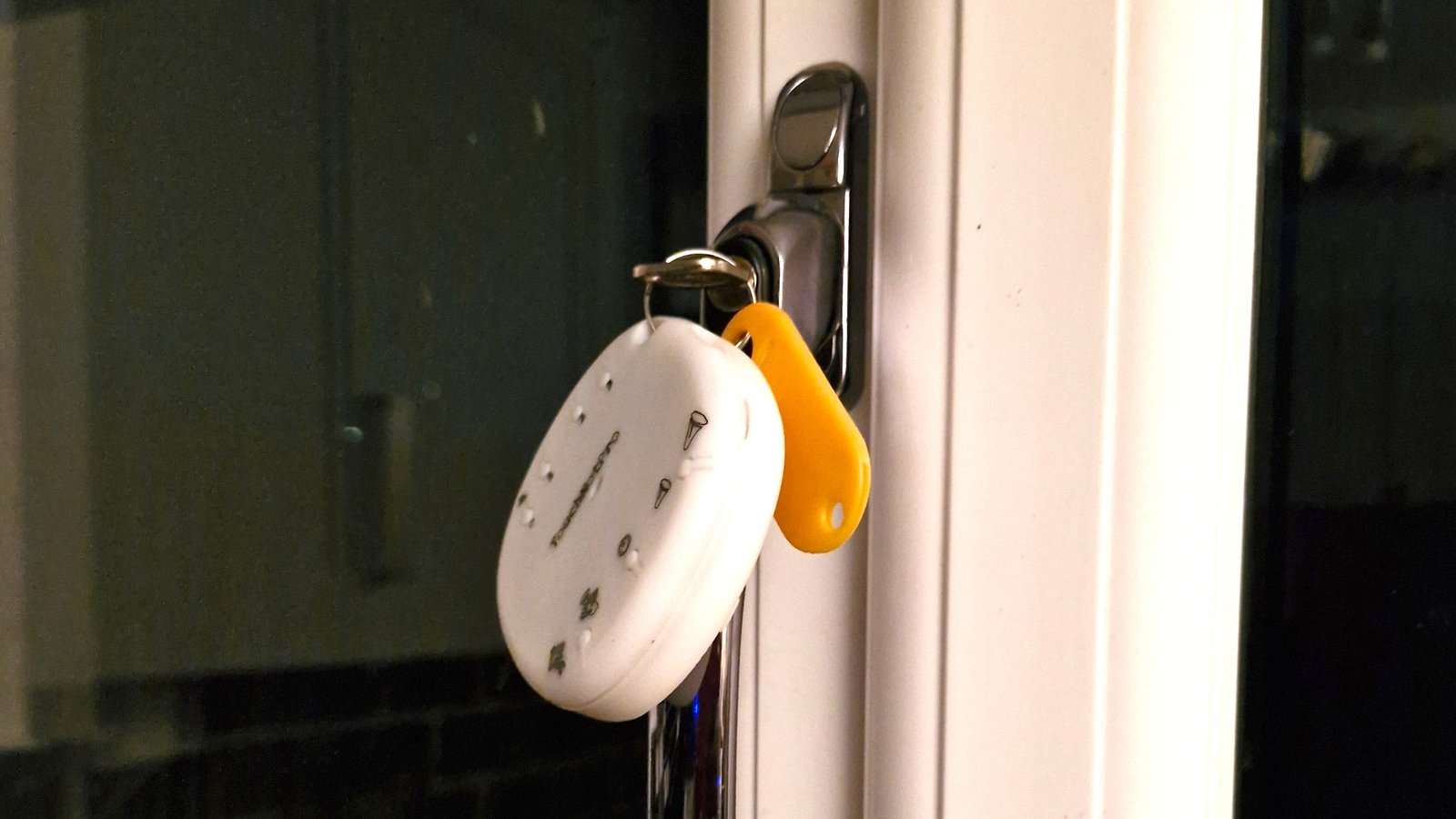

The latest crowdfunded device, known as the ‘TouchNot Pro’, is a smart tag designed to keep personal possessions safe and prevent theft from happening in the first place. It has both touch and motion sensors onboard to monitor the item and the area around it. Beyond that, the TouchNot Pro smart tag offers some useful features to maintain user privacy alongside safeguarding personal belongings. Therefore, if any sort of suspicious activity occurs, it gets triggered and sounds an ear-splitting alarm that is enough to make anyone  alert and get notified about the possible chances of theft.

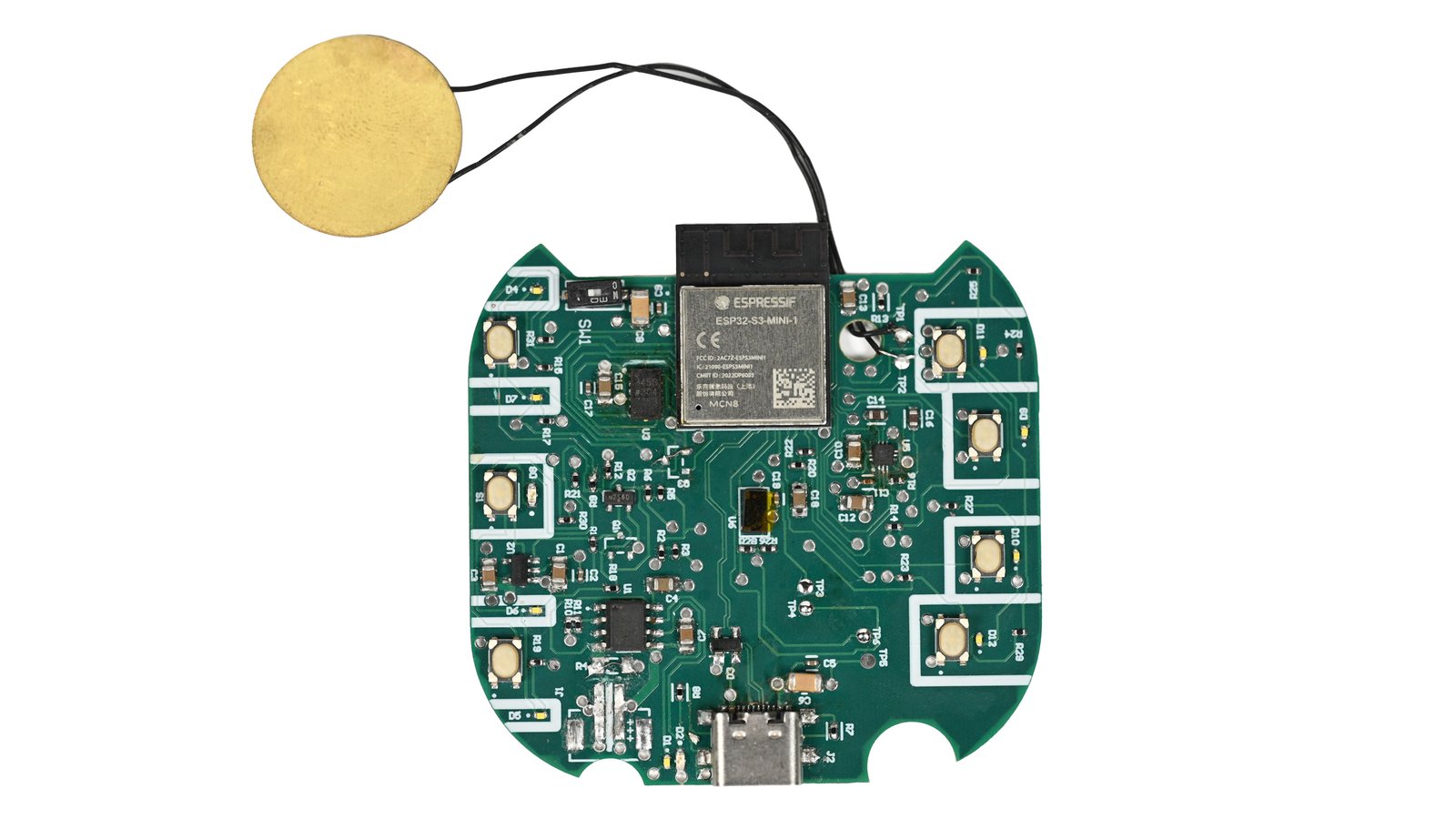

The TouchNot Pro smart tag is equipped with an ESP32-S3-MINI-1 microcontroller that is powered by a 500 mAh LiPo battery that can last months on standby (as long as the alarm is not being triggered often). To maintain user privacy, the smart tag uses a suite of sensors instead of cameras. Sensing is performed by an Analog Devices ADXL345 touch/vibration sensor and a Texas Instruments VL53l0x time-of-flight motion sensor. This combination enables the device to recognize both physical contact and nearby activity. The device also sends a notification via a subscription-free cloud service to alert the owner without any additional fees.

TouchNot Pro Smart Tag Specifications:
  • SoC: Espressif ESP32-S3-MINI-1
    • CPU: Xtensa Dual-core 32-bit Tensilica LX7 microcontroller (with single precision FPU) @ up to 240 MHz
    • System Memory: 512KB SRAM
    • Storage Memory: 384KB ROM and up to 8 MB Quad SPI flash
  • Wireless Connectivity:
    • Wi-Fi: IEEE 802.11 b/g/n 2.4GHz & 5GHz bands
    • Bluetooth LE: Bluetooth 5, Bluetooth mesh
  • Sensors:
    • Analog Devices ADXL345 touch/vibration sensor
    • Texas Instruments VL53l0x time-of-flight motion sensor
  • Misc:
    • 30 mm buzzer | PAM8907 buzzer driver
    • 9x Indicator LEDs
    • 7x Buttons
  • Power Supply:
    • USB Type-C port for charging and debugging
    • Built-in 500 mAh Li-Po battery
    • 9 uA deep sleep
    • ~300 days uptime (assuming the alarm is not triggered)
    • Average 70 uA power draw (both sensors armed, sleep mode)
  • Weight: 30 grams (1.06 oz)
  • Dimensions: 70 x 67 x 20 mm (2.76 x 2.64 x 0.79 in)
TouchNot Pro Smart Tag board

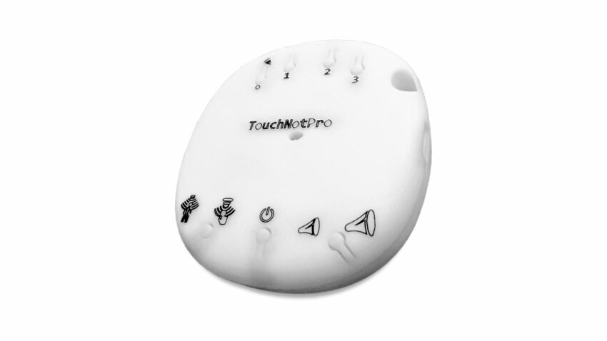

TouchNotPro smart tag comes with essential features like its auto-wake functionality, motion pattern detection, customizable scheduling, smart home integration, and a silent alarm mode. When the alarm is triggered, users can quickly deactivate it using a four-button PIN with TouchNot Pro’s physical buttons.
The user interface consists of nine LEDs and seven pushbuttons, and there are also Android and iOS apps available for more advanced configuration of the device. In terms of Hardware and Software, the TouchNotPro smart tag is fully open-source.
