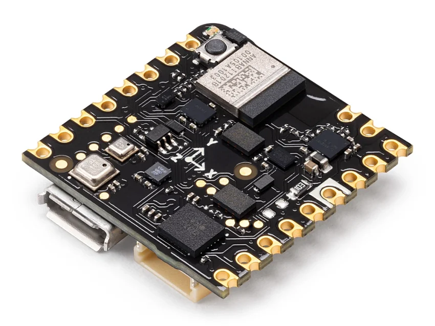

Edge Impulse has announced support for Arduino's compact Nicla Sense ME board targeted at Edge AI Motion and Environment projects -- a new standard for intelligent sensing solutions. The edge AI and tinyML expert promised to give full support for the device's newly integrated sensors.
Edge Impulse has announced support for Arduino’s compact Nicla Sense ME board targeted at Edge AI Motion and Environment projects — a new standard for intelligent sensing solutions. The edge AI and tinyML expert promised to give full support for the device’s newly integrated sensors.
Less than a year ago, in September 2021, Arduino partnered with Bosch’s sensor division to launch the Nicla Sense ME, development board, with a stamp-like ultra-compact design. The high-performance, low-power board was designed to bring smart sensing solutions to the edge.
“Its small size and robust design make it suitable for projects that need to combine sensor fusion and AI capabilities on edge, thanks to a strong computational power and low-consumption combination that can even lead to stand-alone applications when battery operated,”
Edge Impulse’s Jenny Plunkett explains the compact development board.
Features and Specifications Include:

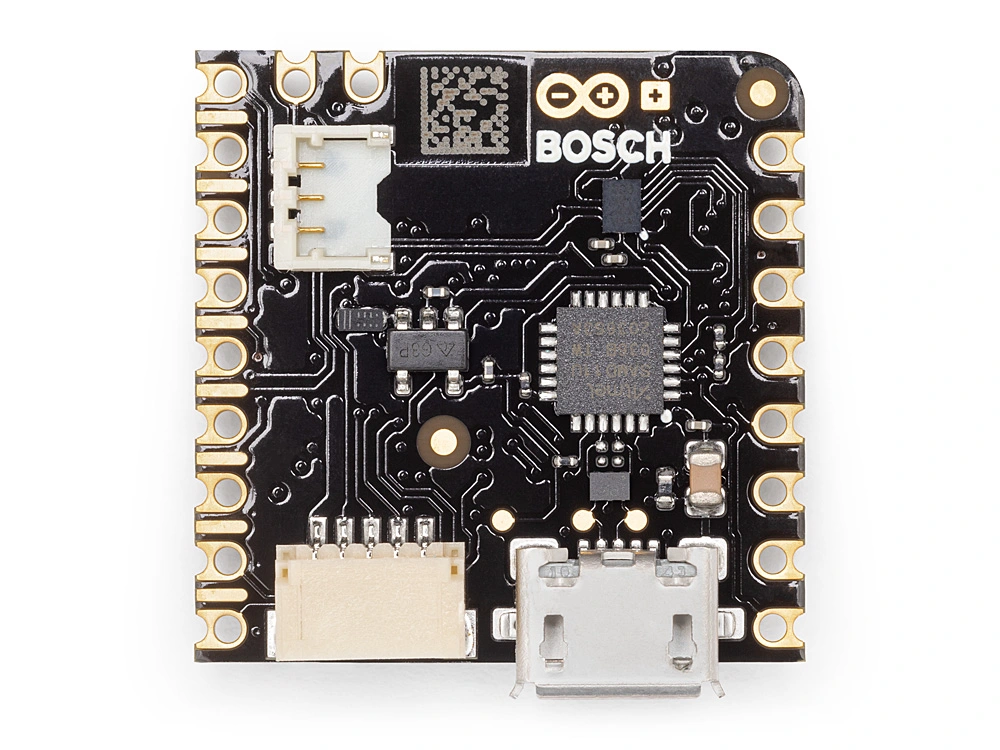

  • 64 MHz Arm® Cortex M4 (nRF52832) microcontroller
  • Bluetooth® 4.2 connectivity
  • 512KB Flash / 64KB RAM, 2MB SPI Flash for storage, 2MB QSPI dedicated for BHI260AP
  • 1x I2C bus (with ext. ESLOV connector), 1x serial port, 1x SPI, 2x ADC, programmable I/O voltage from 1.8-3.3V
  • Power: Micro USB (USB-B), Pin Header, 3.7V Li-po battery with Integrated battery charger
  • Dimensions: 22.86 mm x 22.86 mm
  • Weight: 2 grams

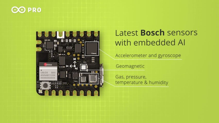

Edge Impulse also extended support to four state-of-the-art sensors from Bosch Sensortec:
  • BHI260AP motion sensor system with integrated AI
  • BMM150 magnetometer
  • BMP390 pressure sensor, and,
  • BME688 four-in-one gas and environment sensor with AI and integrated high-linearity.
With the range of Bosch Sensortec hardware and the powerful Nordic Semi nRF52832 system-on-chip, the Nicla Sense ME compact development board can be used to easily measure and analyze rotation, acceleration, temperature, pressure, humidity, air quality and CO2 levels.

  • Robust hardware including high-quality Bosch sensors with embedded AI (accelerometer, gyroscope, geomagnetic, gas, pressure, temperature & humidity sensors)
