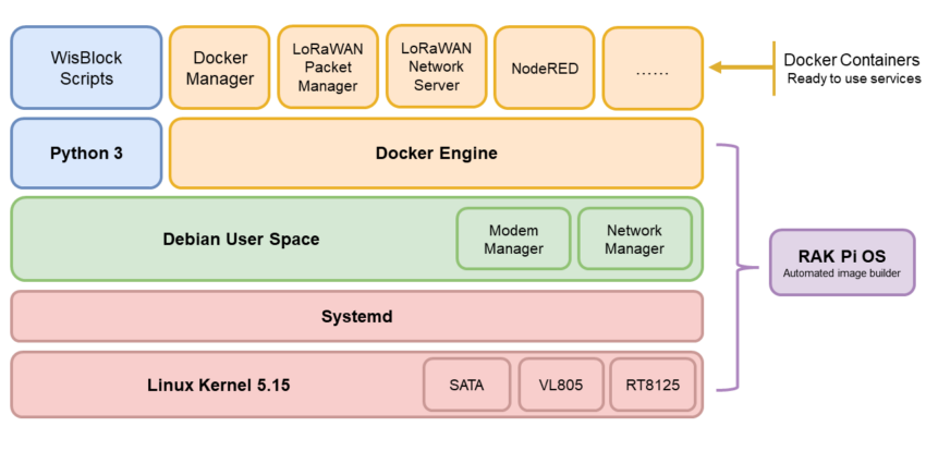

WisGate Connect Kit Software Structure
RAKWireless also provides a remote management platform for the WisGate Connect Gateway– WisDM. The WisDM platform provides numerous features for remotely accessing the WisGate gateway, like remote rebooting, prompt notifications of anomalies, analysis reports, etc.
