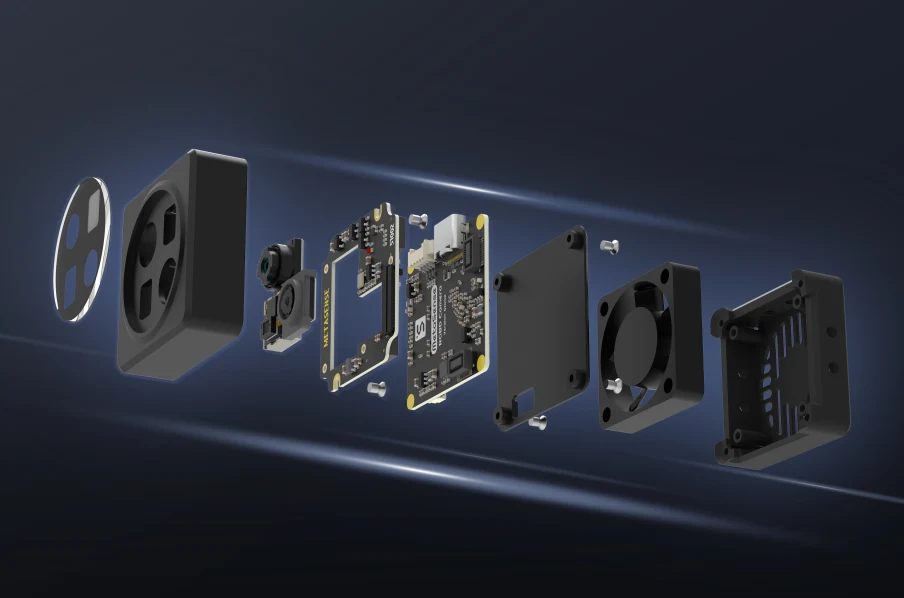

MetaSense announced the development of two ToF Cameras – A075V, and A010. These cameras provide the coordinates in XYZ-axis, enabling the users to form a point cloud.
The A075V has a higher resolution of 320×240 as compared to the A010 with a resolution of 100×100. Moreover, the A075V has additional an RGB sensor and an Inertial Measurement Unit (IMU). The RGB sensor enables A075V to create colorful point clouds that can be used in applications like 3D scanning and 3D sense reconstruction.
It also features a powerful CPU along with an NPU (Neural Processing Unit) for processing complex data. Users can conveniently access the processed data just through a USB cable. The A010 is cheaper than A075V, making it ideal for beginners. It can be configured to different resolutions like 100×100, 50×50, or 25×25 depending on the microcontrollers used. Both the 3D cameras support integration with ROS1 and ROS2.

MetaSense A075V:
  • Dimensions: 36x36x23.5 mm
  • 128MB RAM, 128MB ROM
  • Cortex A7 processor (1.5GHz) with 0.4T NPU
  • UART and USB2.0 ports
  • Distance measurement range : 0.2-2.0 m
MetaSense A010:
  • Dimensions: 23.25×40.70×10.50 mm
  • 132KB RAM, 192KB ROM
  • 32-bit RISC-V processor (144MHz)
  • Distance measurement range: 0.2-2.5m
