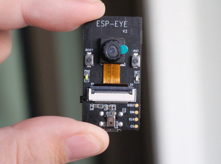

At the core of the board is the ESP32 dual core Tensilica LX6 processor, 8 MB PSRAM and a 4MB flash. The ESP EYE integrates a digital microphone as well as provides an external 2-million-pixel camera making it capable of AI features such as face detection, face recognition, speech recognition, and voice wake-up which are all supported out of the box. The board can also support image transmission over Wi-Fi and debugging using the Micro USB port, which enables user’s development of advanced AI solutions.
The board shares similar traits with the ESP32-CAM camera board which includes a micro camera, only that it adds a microphone, it’s an “official” Espressif product which will translate to more software support, and it is smaller than the CAM board as well.
The software stack that will power the ESP-EYE is their own ESP-WHO framework. The voice wake-up command for the ESP EYE is “Hi Lexin,” and the board will successfully wake itself up by switching on the Red LED while the white LED goes off.

  • WiSoC- ESP32 dual core Tensilica LX6 processor with WiFi and Bluetooth
  • Memory – 8MB PSRAM
  • Storage – 4MB flash
  • Camera – 2MP OV2640 camera
  • Audio – Microphone
  • USB – 1x micro USB port for power and programming
  • Misc – Reset, boot and function buttons, 2x LEDs
  • Dimensions – 41 x 21 mm

As raised on Reddit by some users, whether “Face detection is done on board or images are streamed to open CV somewhere,” ESP-EYE definitely do the face detection on board. The ESP-EYE is going to open up new applications for newer and existing projects in the areas of computer vision, imagine what you can do with hacking an Arduino to work together with the ESP-EYE. You can create a low-cost AI project. I need to get my hands on one now!
