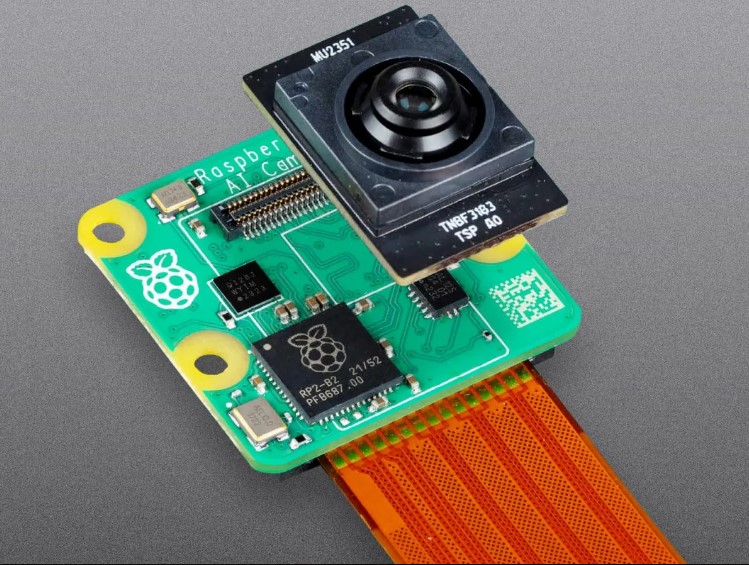

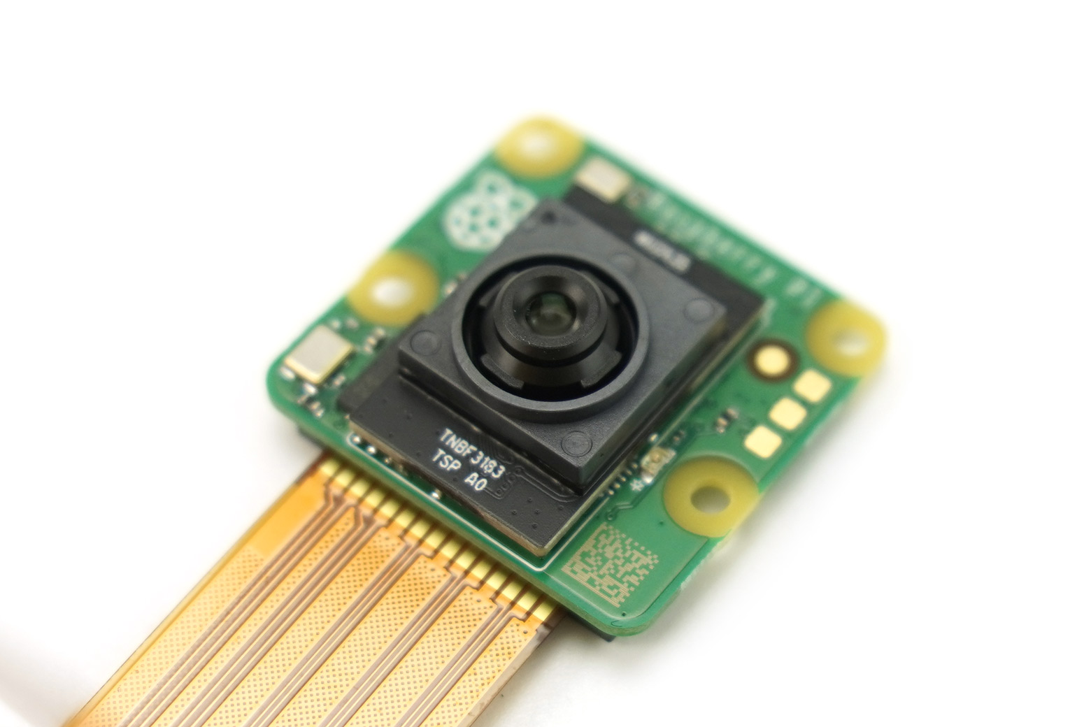

Equipped with the Sony IMX500 imaging sensor, this module enables low-latency, high-performance AI processing for a variety of applications. It captures images and videos enriched with tensor metadata and supports on-sensor model execution using an integrated accelerator with 8MB of dedicated memory. This allows real-time object detection, segmentation, pose estimation, and more, making it a versatile tool for AI-powered camera projects.

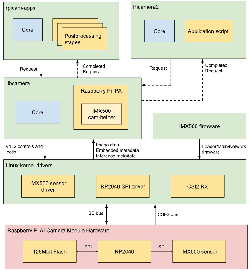

The AI Camera offloads processing from the Raspberry Pi’s CPU and GPU, allowing them to handle other tasks efficiently. Supported by libraries such as libcamera, Picamera2, and the rpicam-apps suite, it enables users of all skill levels to create advanced AI vision applications.

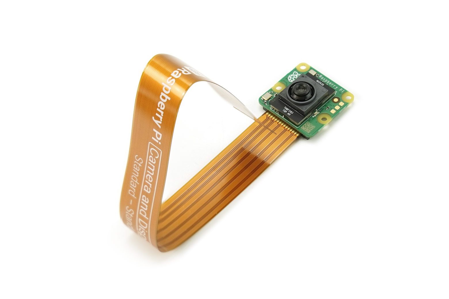

    • Connector: 15 x 1 mm FPC or 22 x 0.5 mm FPC

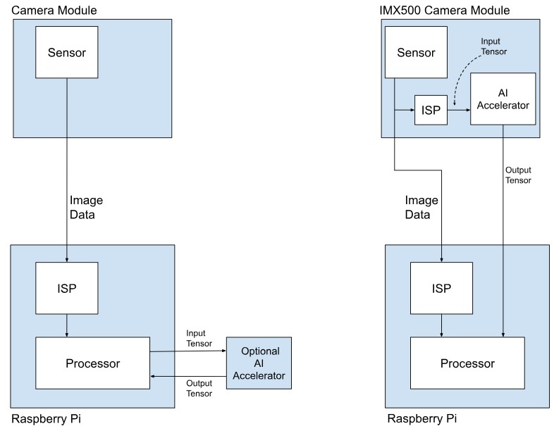

The left side of the image illustrates the architecture of a traditional AI camera system. In this setup, the camera captures images and sends them to the Raspberry Pi for processing and AI inference. These systems often rely on external AI accelerators or the CPU to perform inference tasks, adding complexity and resource dependency.
In contrast, the right side of the image showcases a system utilizing the IMX500 sensor. Here, the camera module includes a built-in Image Signal Processor (ISP) that converts raw image data into an input tensor. This tensor is processed directly by the AI accelerator within the camera, which generates output tensors with the inference results. These results are then sent to the Raspberry Pi, eliminating the need for external accelerators or neural network processing on the CPU. This streamlined approach enhances efficiency and reduces the hardware requirements for AI tasks.
Raspberry Pi AI Camera system architecture
