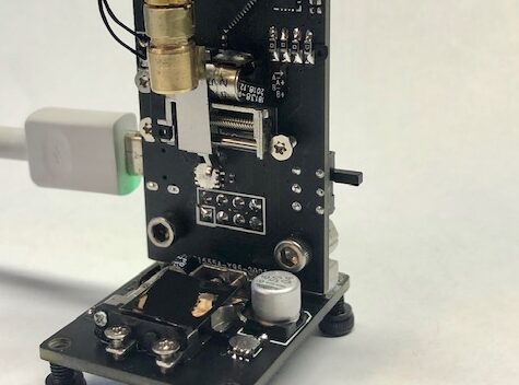

As a way of experimenting with a few linear stepper motors from Aliexpress, Mike-Rankin recently decided to build a laser engraver which he called the ESP32 Burninator. The device, whose name was inspired by Mike’s long time fandom of the homestarrunnerdotcom videos, at its core comprises of an ESP32,  two linear stepper motors, and a DVD burning laser diode.

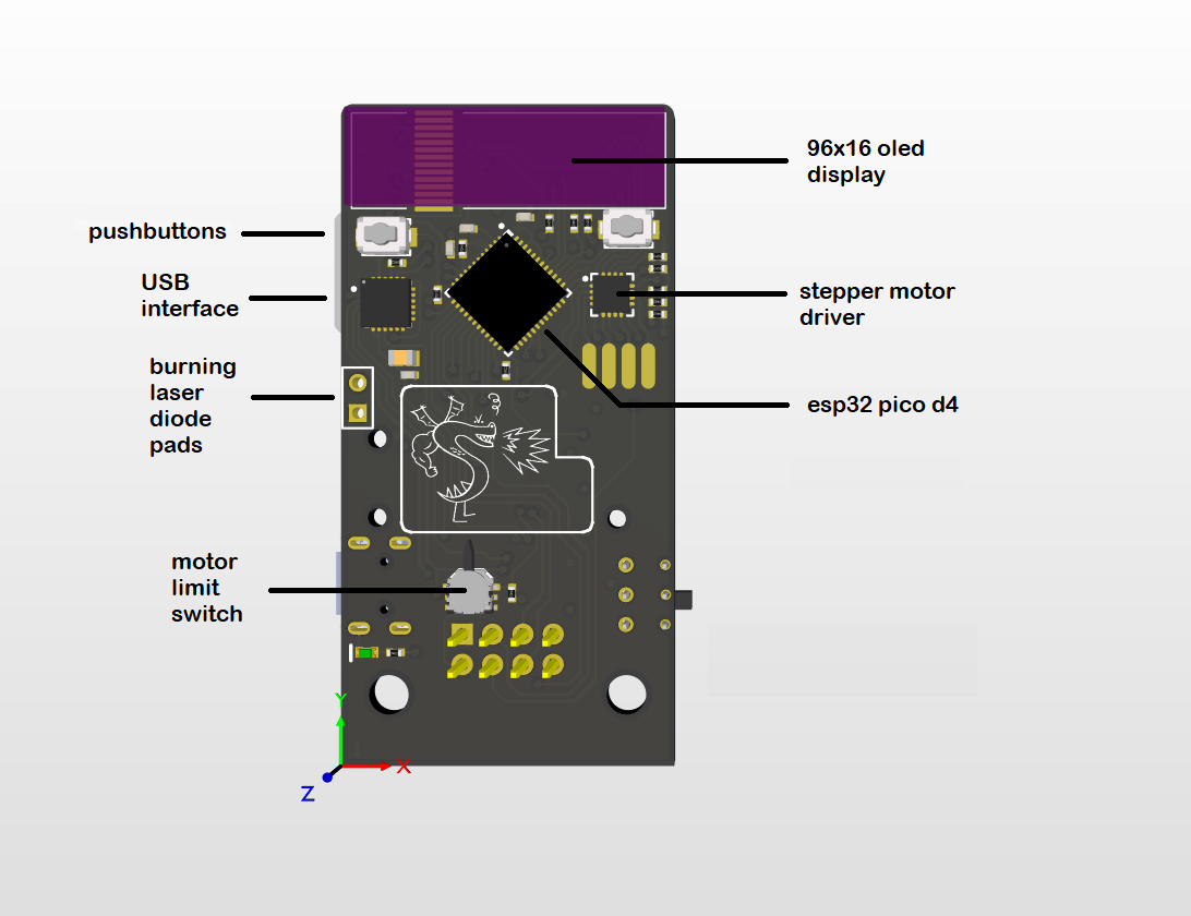

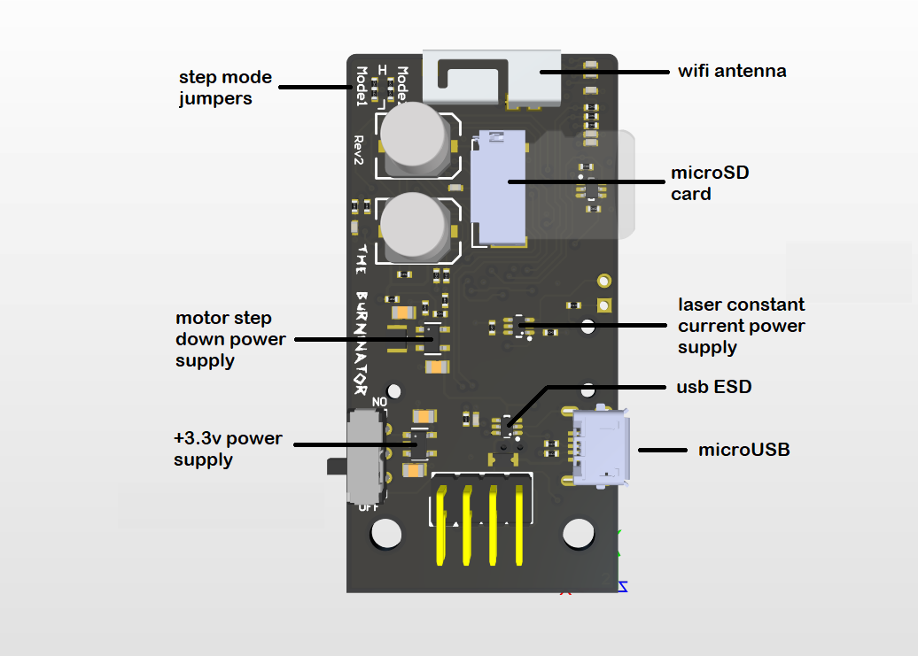

Mike developed a custom board for the project, designing his own ESP32 board with the components arranged in a way that suits all the other elements of the project.  While the stepper motors lacked the level of strength that could make them useful for cutting or drawing, they have just enough strength to serve as the arm that is used to move the DVD burning laser diode, and also serve as the base on top of which the paper to be engraved on was placed.
For focussing the laser, a tiny adjustable lens from the popular laser diodes used in several Arduino projects was savaged by pulling out the visible diode component and replacing it with the DVD diode.
