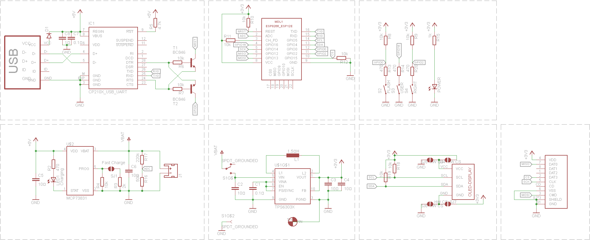

The Device has SSD1306 based OLED display, microSD card socket, 3 general purpose buttons, ESP8266-12E module, TPS63031 Buck-/Boost converter with an input range from 1.8V – 5.5V, MCP73831 Single-Cell LiPo Charger Chip and CP2012 USB to UART converter chip.
ESPTool_SCH

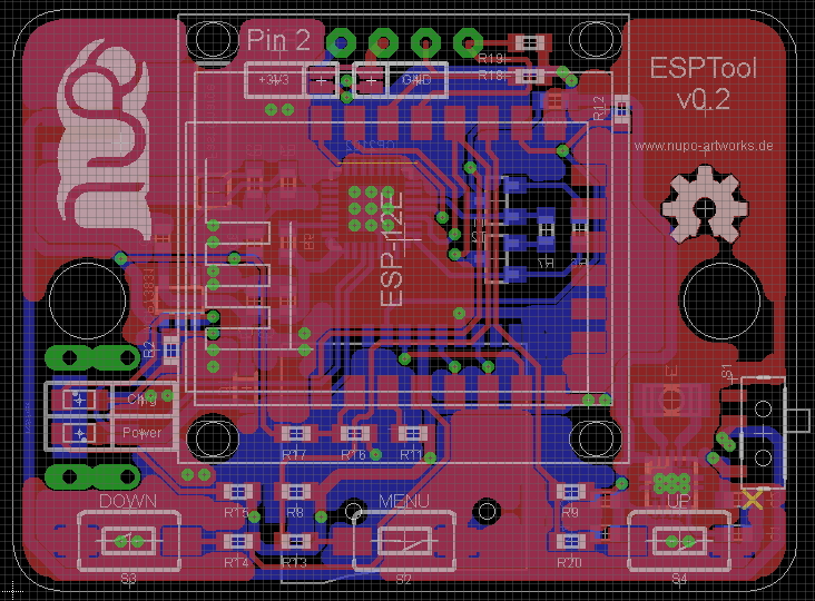

ESPTool_PCB
The source code and the design files, using Eagle CAD, (SCH & BRD) can be found here.
