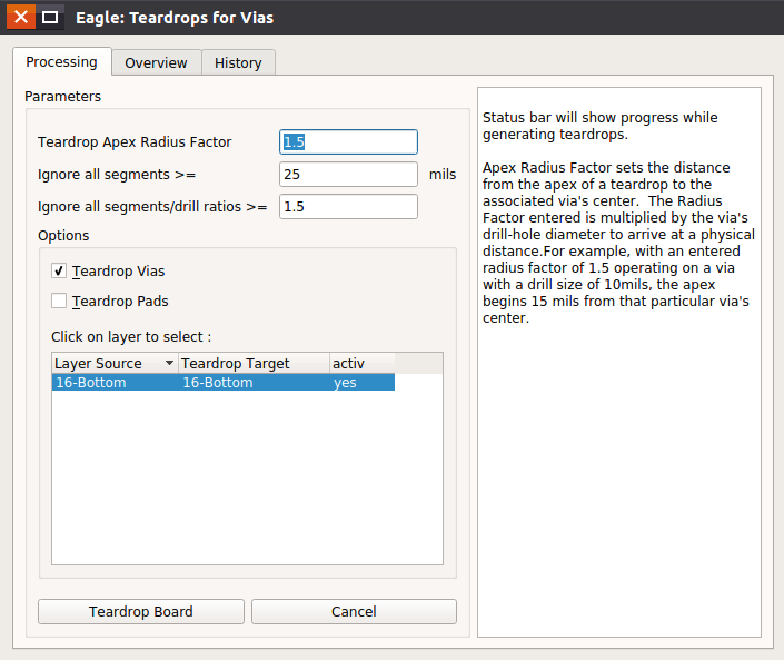

This ULP should be used with forethought or on a copy of your board file just before plotting because it would be difficult to remove teardrops afterwards. Once added, they can’t be undone using ctrl-z.
Teardrop.ulp GUI
Teardrop.ulp GUI

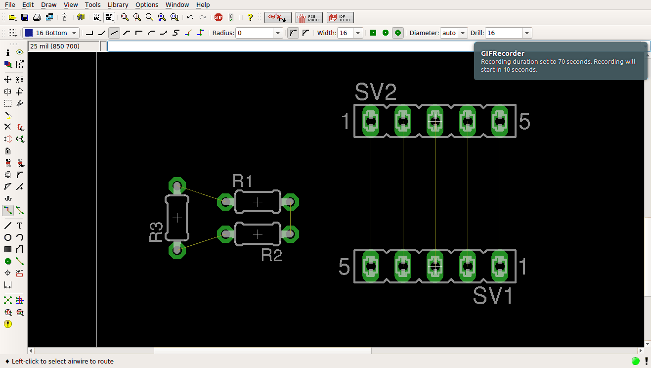

In the GIF below, I tried to demonstrate how to use this ULP.
teardropulp
Note: You don’t need to download and add this ULP. it’s available in the ulp directory.
To use it, just press the ULP icon from the tool-bar and search for ‘teardrop.ulp’.
