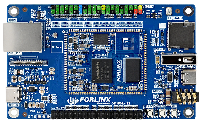

OK3506-S12 - RK3506J based Mini SBC Top Side
OK3506-S12 Mini SBC Top Side

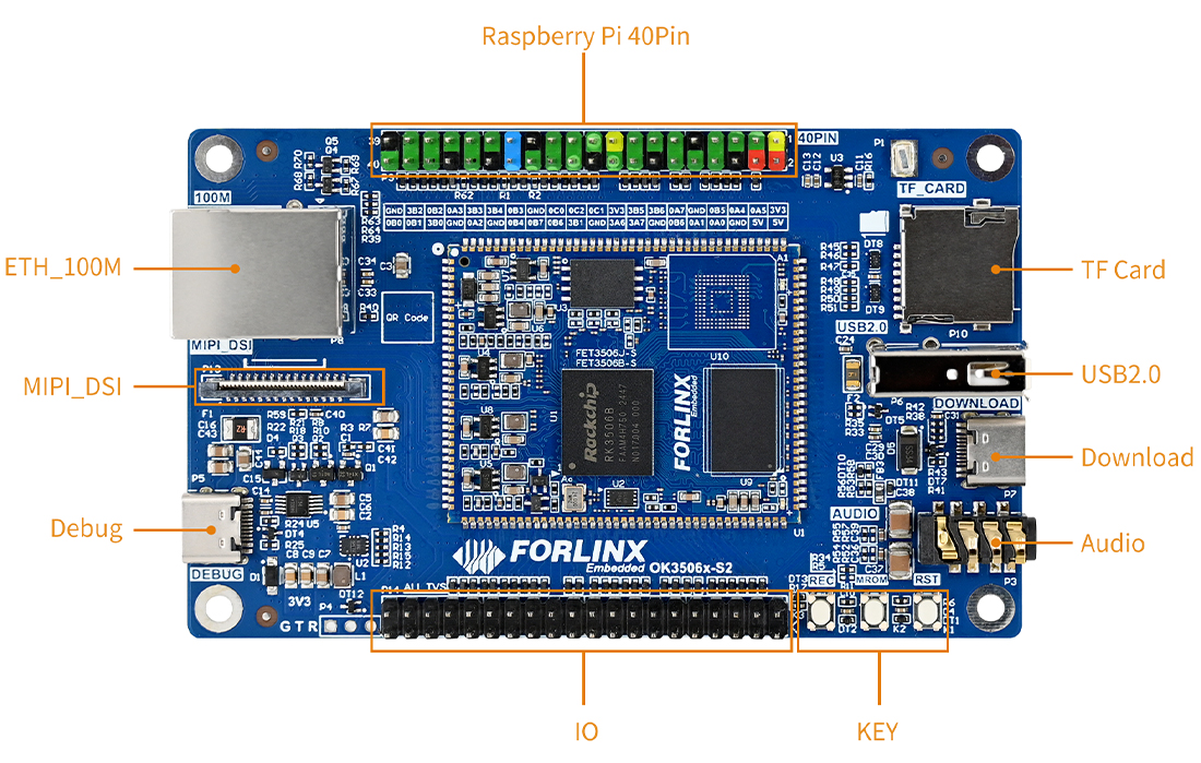

Forlinx OK3506-S12 Mini SBC Specifications:
  • Processor: Rockchip RK3506J with 3x Cortex-A7 cores @ up to 1.5GHz + 1x Cortex-M0 coprocessor
  • Memory: 256MB or 512MB DDR3
  • Storage: 256MB or 512MB NAND Flash (eMMC version optional, no SDIO)
  • GPU: 2D graphics engine
  • Display:
    • 1x MIPI-DSI, 2-lane, up to 1.5Gbps per lane
    • 1x RGB888, up to 1280 x 1280 @60Hz
  • Expansion: 40-pin Raspberry Pi-compatible GPIO header
  • Connectivity:
    • 2x USB 2.0 (1x OTG)
    • 2x 10/100Mbps RMII Ethernet
    • 2x CAN-FD
    • Up to 6x UART, 3x I²C, 3x SPI
  • Additional interfaces:
    • FLEXBUS / DSMC for PSRAM, FPGA, or LCD
    • 4x SARADC (10-bit, up to 1MS/s)
    • 12x PWM (11 usable)
    • Up to 76x GPIO
    • 4x SAI audio, 1x SPDIF, 1x PDM mic
  • Power consumption: ~0.7W under load
  • Operating temperature: 0°C to +70°C
  • Dimensions: 44 x 35 mm SoM (Stamp-hole, 146 pins, 1mm pitch)
