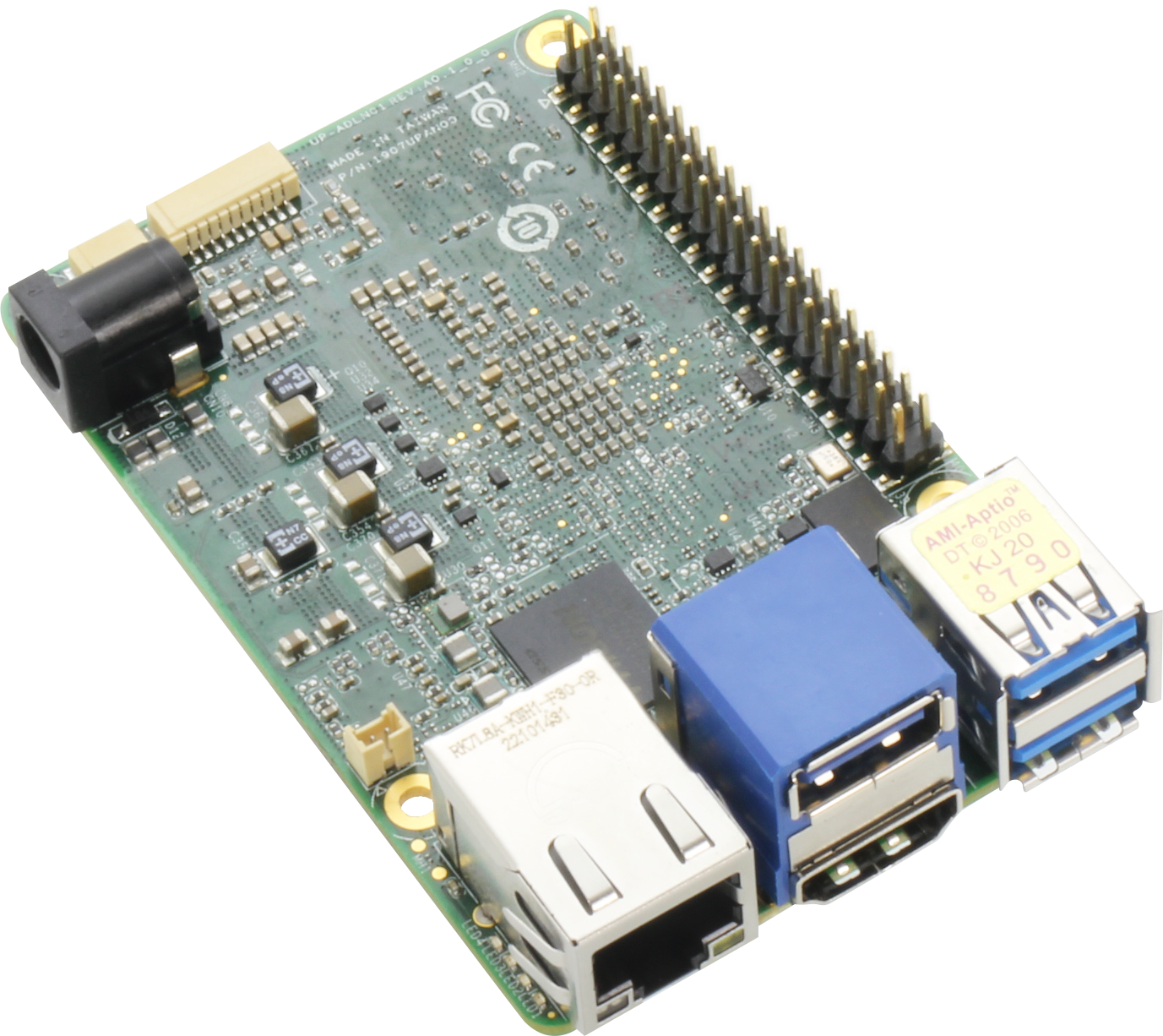

LattePanda Alpha 864
With the LattePanda Alpha, there is the option of a cheaper barebones version that supports an optimized, downloadable Ubuntu 16.04 LTS image. It seems that the only LattePanda Alpha model currently in stock and only at DFRobot is the $358 barebones version with 8GB LPDDR3 and 64GB eMMC. A $298 barebones model without the 64GB eMMC and a $398 model with 64GB eMMC and Windows Pro 10 are both listed as pre-order, without a specified shipment date.
The $358 price for the Linux-ready model is $60 to $70 more than the original Kickstarter packages. The LattePanda Alpha’s 7th Gen Kaby Lake Core m3-7Y30 is a dual quad-thread 1.6GHz/2.6GHz processor with 900MHz Intel HD Graphics 615. The processor has a configurable TDP of 3.75W to 7W, and like the original LattePanda, has an Arduino-compatible co-processor.
There’s also a microSD slot and an M.2 M Key interface that supports PCIe x4, SATA SSD, and NVMe SSD expansion. The Alpha is also fitted with an M.2 E-Key slot with PCIe x2, USB 2.0, I2C, and UART support. This gives additional wireless options in addition to the standard dual-band 802.11ac, which is accompanied by Bluetooth 4.2. A GbE port is also onboard. The Alpha provides 3x USB 3.0 host ports and a USB Type-C port with support for USB 3.0, power input, and DisplayPort. Dual simultaneous 4K display support is accessible through the Type-C DisplayPort, as well as an HDMI port and eDP interface that supports optional 7- and 10.1-inch touchscreens. Other features include a 12V input, an audio jack, a PMIC, an RTC, and a cooling fan. Also, the dual 50-pin GPIO connectors include one with an Arduino pinout.
