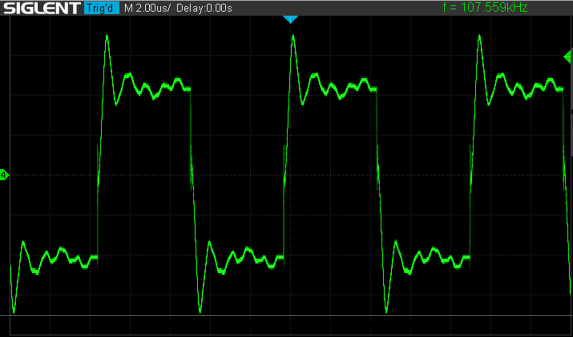

In this article, the piezoelectric transducer with a resonant frequency equal to 108 kHz is used. SLG47105 has an oscillator OSC1 with a flexible divider, which allows to accurately set the desired frequency.
Figure 2. Signal between Transformer Inputs
Additionally, D Flip-Flop (DFF0) is used to get a 108 kHz clock signal from the oscillator’s output signal. HV_GPO0_HD and HV_GPO1_HD are high voltage and high drive pins that allow to get the desired output power (see pins output signal in Figure 2). A transformer has a turns ratio of 5:1. It allows getting from 5 V the required voltage for the operation of the piezo converter.

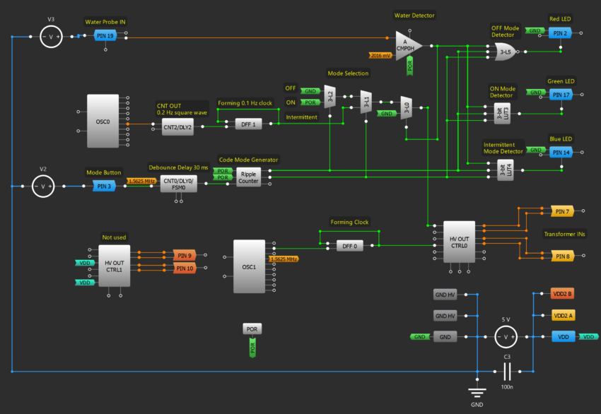

Figure 3 shows an internal design of the project created in GreenPAK Designer software (a part of Go Configure™ Software Hub). The complete design file can be downloaded here
Figure 3. GreenPAK Designer Project
2.1 Humidifier Modes of Operation
For flexibility in use, the humidifier has three modes of operation: OFF state, ON state, and intermittent operation. The last mode means that the humidifier works for 5 s and then waits for 5 s, and so on alternately. Digital logic macrocells were used to implement these modes. An external button is used to select a mode of operation. It produces noisy output oscillations due to switch bouncing. To eliminate that noise 30 ms delay is used. With every pressing of the button, Ripple Counter generates a digital code for the appropriate mode. There are three modes of work and, respectively, three digital codes: 00, 01, 10. The output signal from Ripple Counter goes to select inputs of cascaded multiplexers (3-L1 and 3-L2) and thus allows to choose which signal will pass to the output: LOW level signal (OFF mode), HIGH level signal (ON mode), or clock signal with frequency 0.1 Hz (Intermittent mode). And, if there is water inside the humidifier, multiplexer 3-L0 allows passing one of the signals from cascaded multiplexers on the Enable input of the HV OUT Control macrocell.
For Intermittent mode, Reset Counter2 and DFF1 form a 0.1 Hz clock signal.
LEDs indicate mode of operation: red LED – OFF mode, green LED – ON mode, blue LED – Intermittent operation. LUT3, LUT4, and LUT5 detect each mode and turn on the corresponding LED with the help of pins. Pins work as 3-state outputs. When a HIGH level signal appears on the pin’s Output Enable input then the pin goes from a high impedance state to a logic 0 state. This LOW-level signal causes the corresponding LED to turn on. For a more advanced experience, when the humidifier is in OFF mode, it can be used as a night light with a red glow.
2.2 Water Level Detection
One of the negative features of ultrasonic humidifiers is that the piezoelectric disc can be destroyed if the humidifier runs out of water. That’s why it is very important to implement an automatic shut-off of the humidifier when the disc is dry. In this project, probes immersed in water were used. When there is no water between the probes, an analog comparator’s output is HIGH, which disables high voltage pins and stops piezo disc oscillation.

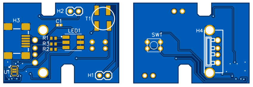

The dimensions of the PCB and the location of the main components of interaction with the user were measured. Based on these data, the PCB for the SLG47105-based humidifier was developed (see Figure 5).
Figure 5. Humidifier PCB Top and Bottom View
The humidifier based on the SLG47105 has some advantages over the purchased humidifier because it has water level detection. This function is very important because it can prevent the humidifier from failing. In addition, the number of electronic components has been reduced when using SLG47105.
