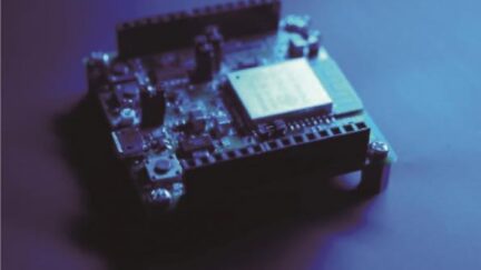

RPGA Feather is an RP2040 and iCE40 FPGA Powered Dev Board in A Adafruit Feather From Factor
RPGA Feather by Oak Development Technologies is an RP2040 and iCE40FPGA-powered development board in an Adafruit Feather form factor. The board is tiny and features an MCP73831 1S LiPo charger, a USB 2.0 Type-C connector for power and programming, and an RGB LED driven by the FPGA Speaking of the FPGA it's an ultra-low-power iCE40 Ultra product family designed for mobile applications such as smartphones, tablets, and handhelds, it features 3,520 logic cells 80 Kbits of embedded Block RAM, and much more.
Speaking of the FPGA it’s an ultra-low-power iCE40 Ultra product family designed for mobile applications such as smartphones, tablets, and handhelds, it features 3,520 logic cells 80 Kbits of embedded Block RAM, and much more. Previously we have seen Oak Development Technologies introduce the IcyBlue Feather 2 and IcyBlue Feather, both powered by the iCE40 FPGA module.
