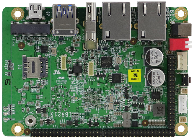

IBR215 SBC

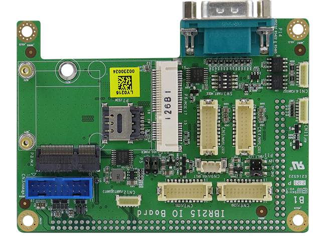

The IBR215 features multiple display interface (HDMI and dual-channel LVDS), a 5G-compatible M.2 3052 socket, 3GB LPDDR4 system memory, up to 64GB eMMC flash memory, external I/O including one HDMI 2.0a, two USB 3.0, two GbE RJ45, one USB OTG, and an SD socket, as well as internal headers for two I2C and DC power. Three 2×20 headers on board connect communication and GPIO signals to the IBR215-IO expansion board to provide interfaces for an M.2 E-key socket, an mPCIe socket, one RS232/422/485 port, two USB 3.0, dual-channel LVDS with backlight control, two CAN bus and two MIPI camera serial interface.
IBR215-IO
