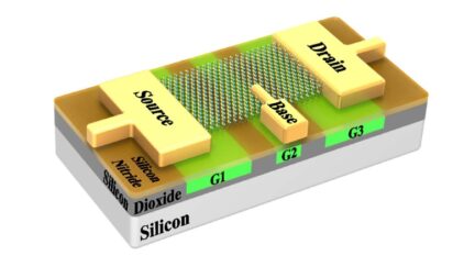

A group of researchers from the Cardiff University has demonstrated the first practical laser that has been grown directly on a silicon substrate. by Graham Prophet: The lasing structure was formed in indium arsenide/gallium arsenide layers grown directly on a silicon substrate; the research group notes that previous work has involved wafer bonding techniques to merge electrical and optical (lasing) structures.
004709_10_fig1
image: spie.org
